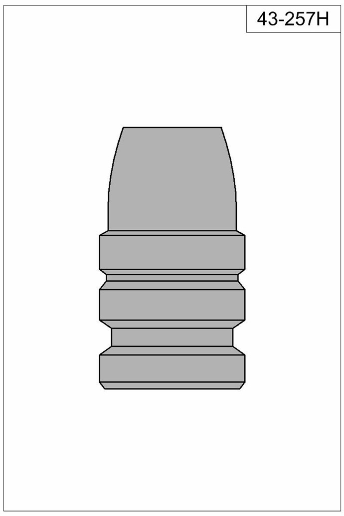

43 257H is probably going to get the most use as it is a Keith type with a front band dimensioned for my revolvers.
The big change is a 0.020” bevel base. The advantage of a bevel base is the reduction of incomplete base fill-out. Incomplete base fill-out seriously compromises accuracy, giving wild fliers. Base fill is easy to evaluate, but the rejects represent a waste of time. A bevel base gives better base fill and fewer rejects, but a normal size bevel base reduces the base band width which can limit maximum velocity. The question is how small can you make the bevel base and still get the casting advantage.
Tom’s excellent machining makes it possible to make a very small bevel base.  A 0.020” bevel base is very small, so it does not detract much from the base band, in fact you have to look closely to see it.
I have not accumulated much casting with the new mold but the casting results are apparent.  Base fill is much improved, base rejects are way down over the plain base molds. I will try to quantify this later with a side by side casting run with a plain base mold.

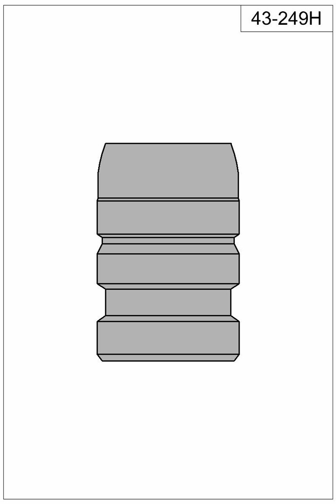

43 249H 3 cavity aluminum
I wanted a replacement for the Lyman “oil drum” 44 bullet #429352. I no longer have that mold, it was traded in a moment of weakness, and I only have a few left.  The resulting bullet looks like a LBT Ogival Wadcutter and should perform just fine. It has more engraved length than #429352, seating depth like a 250 grain Keith SWC. It is designed to fly fast and hit hard at short range.
The aluminum mold performed as expected. It runs best hot, with alloy at least 100 F over liquidus. If I keep up the casting rate quality is excellent. I tried running the two new molds together, no go the iron mold was quite happy but the casting was too slow for the aluminum blocks.

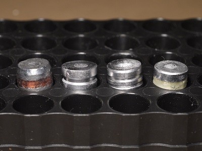

Here is what we are discussing: on the left is a typical commercial cast bullet. The large bevel takes up half the base band.
There is no doubt eliminating the big bevel to give a plain base like #2 will improve high velocity performance.
The #3 and #4 bullets are 0.030 and 0.020 bevel respectively. The small bevels give you better base fill, it is easier to fill two 45 degree corners than a 90 degree corner
Is there an accuracy penalty? Is it significant? That remains to be seen.
Can even smaller bevels be effective? At some point you must lose the easier base fill. Again someone must make a mold to find out.

The accuracy results with 43-249H are excellent. Groups at 25 yards average just over an inch. This is match grade accuracy from a hunting type wadcutter.  Accuracy was better than the Keith type semi-wadcutter, a pleasant surprise. To make this happen the bullet must be a good fit in the revolver, a custom mold made this possible.  A full report will appear in a future Fouling Shot.
