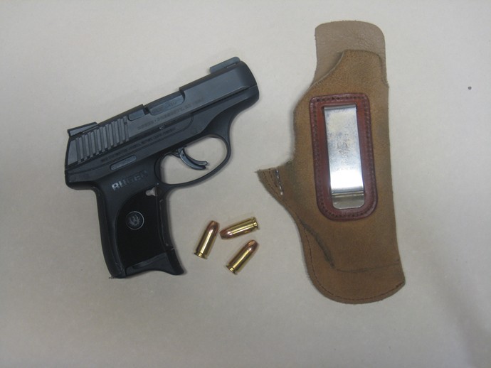

 Ruger LC9s Pro
500 + rounds of factory and reloads, Jacketed, plated, round nose and hollow point, three different weights, with seven different brands of once fired 9mm brass and two different breeds of factory so far without a hiccup. Including a few WWC Nato. Save for two  failure to chamber that were my fault. Trying to bend the bell back with a roll crimp die. Taper crimp die will be coming. And, shoots to the sights.

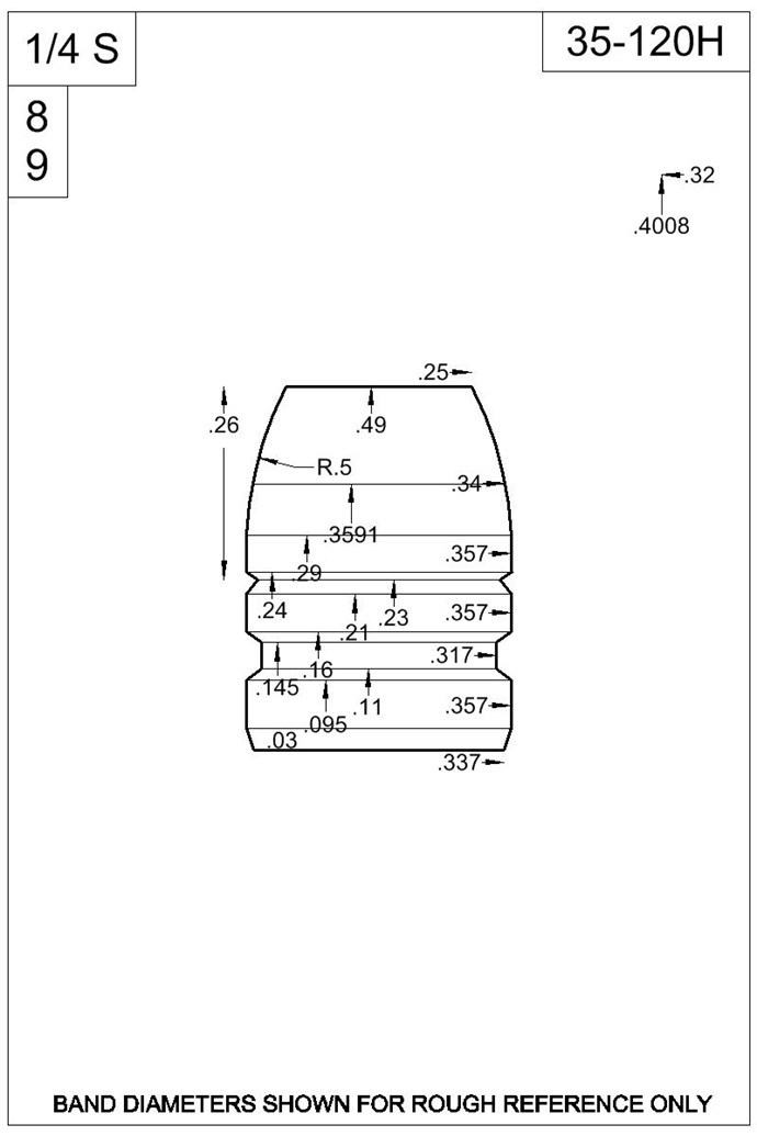

Ed Harris posted this 22 October 2017
I've been using the Accurate 35-120H with great results in the .380 ACP.  Others use it in the 9mm with good results.

Hi I don;t have a mold recommendation for you, but wanted to ask you what sights are those on your pistol?
--------J
R. Dupraz posted this 23 October 2017
j35nut:
Three dot fiber optic. My first experience with these. After using these sights, I am definitely convinced that these were invented solely for us old farts who can't see irons any more. Even after having the lenses replaced in the eyes. I have had handguns over the years with the three white dot sights but they don't even compare with these. All you have to do is to line up the three easily seen bright sharp little "LED's"
I am a believer.
