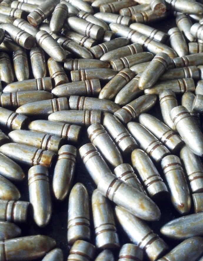

I had Erik at www.hollowpointmold.com bore out the GC heel of a .30 cal. rifle mold for me to make a 7-1/2 degree boattail, plainbase.  It shoots VERY well in the .30-'06 with 6 grains of Bullseye.

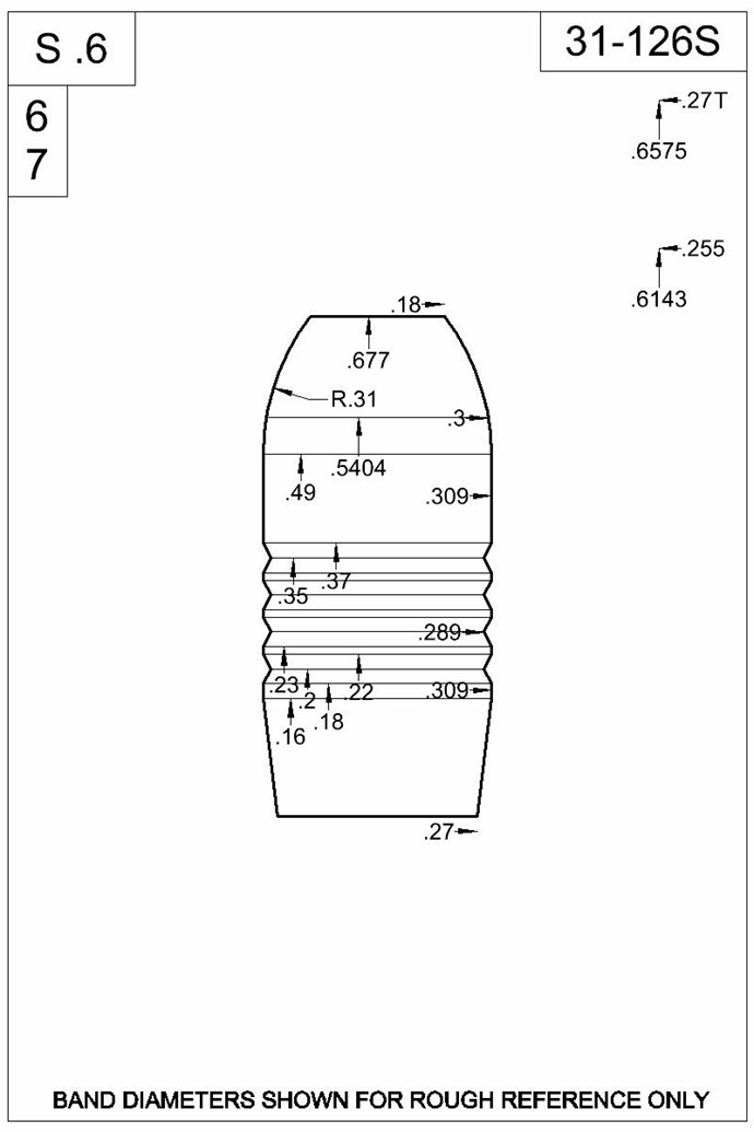

Ed Harris posted this 16 August 2017
TRK hit all of the technical bases, but the REAL reason I did it was because the old NEI mold was worn out. By the time Erik refaced, squared the blocks and fitted a new sprue plate to cure its ills, the GC shank was too short, so he made the bevel.  I wanted this bullet for low noise, subsonic use in .30 caliber rifles with 10-inch twist and the boattail made sense.  The 7-1/2 degrees is what Erik came up with to neatly clean up the old base and GC shank.
The bullet has been absolutely splendid in every way.
Apparently I'm not the only one with this idea, as I found this bullet on Accurate's website.  I cannot take credit for it, but I like it:
