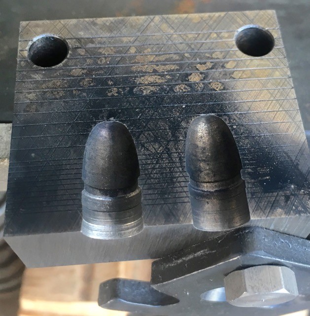

A project over in the single shot world which I will bring this way when further along and more tuned to CBA..... has had me put the device into service. Today I modified an RCBS cadet mold 310-120, for 8mm service with a grease groove. I didn't even mess it up! Got the first cavity correct the first time, get to keep the second cavity as is for a real 310 heeled bullet. Not screwing up for me on the first shot is a welcomed experience!
I have attached some pics of the thingy--- the mold cut and a sample.
I needed .325+ for a project pea shooter and this was a standing candidate. Its also supposed to serve sized to .323 (which I may open the other cavity to at some point rather than size .004) for a 32-20 cadet which I have opened the neck/throat to 8mm as a quasi-wildcat 8mmx32-20. Actually trying to make the cadet shoot proper with its 32-20 chamber. The bullets fall from the mold, seriously like jump out. Ive never cast with a mold that they fall from like this. And they fall perfect. And they fill out. And they are a perfect form of the cavity (which I molested nicely but still will be amazing when sized.)

The work holder uses precisely ground t-nuts, ground chuck jaws, extremely square. The Jaws simply get finger tight and then you tap with a deal blow to shift the mold as precisely as .0002  (when the jaw tension is right) Im able to dial out all but a could ten thousandths on the existing mold (or at least I was able to today( The RCBS mold was less than concentric and it is now much closer. The falling bullets speaks volumes to the concentricity. Additionally the system allows me to remove the mold block completely, cast with it, take it apart, install in chuck, not lose ANY references of ANY KIND, dead blow a few taps and dial right back in. Ask me how I know.......LOL, did it 3x today. After I figured out the front band was in need of another .002 depth and the driving band was a bit tapered due to my tool flex (will do better next time). I attempted to correct the taper at driving band and added the depth and a bit of width to the front band.Made me happier when all done. It was much fun and I intend to make a habit of screwing up more molds that are already screwed up. And I have more than a few of them that are buggered from Lyman.........

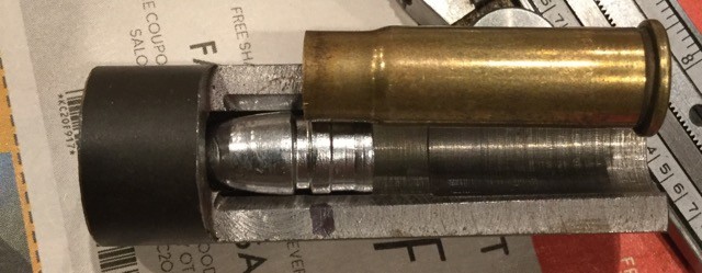

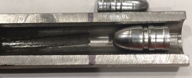

The test chamber #1 cutaway is of a cartridge I'm wildcatting in bottleneck form. The throater/neck was DESIGNED for the 8x32-20 with a thin neck wall and .323/.324 bullet. I adapted the throater to the bottleneck attempt, neck wall is a bit thick but the bullet fits nicely in the throat as cast (will fit better at .325 sizing next week when die arrives)

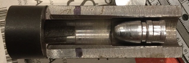

Test chamber #2 cutaway is a variant with long tapered body. Throat is set for a 190-200 grain .322 bullet. Bad news but the body form is correct for the purpose.
Not to digress off topic, but using several form tools and generic chamber reamers to accomplish the prototype work. At some point the throat/neck will adapt to the final format chosen via custom reamers.
Sharpie marks indicate roughly the end of the neck with relation to the bullet position in throat.
