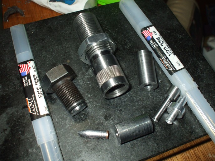

I made a bump die, bump die stop and removing stem from  machinable 12L14 steel.  . Die and die stop fits closely inside a hollow LEE case flaring die. The matching NOE nose stem acts as a stop inside die while RCBS press cams over exactly on each bullet. Bullet is compressed about 1/32” for good results. The hollow tip of removal stem was filled with JB Weld and cured to bullet and then to protect nose during removal. Mc-Master Carr supplied the .220 and .227 reamers...very fast shipping. .2205 diameter is also available.
The pointed NOE 80 grain bullet is undamaged and more uniform diameter entire length of bore ride section AFTER Sqeezing larger

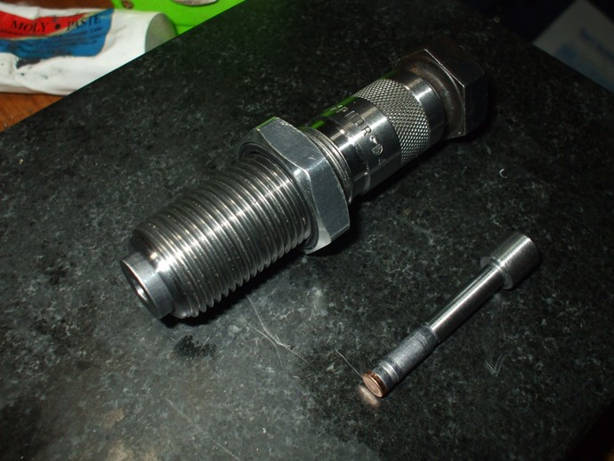

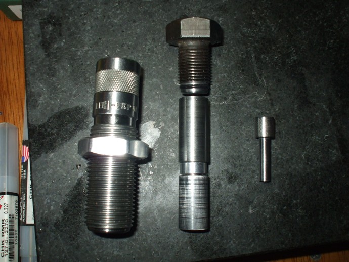

Here is the die assembled. Die and NOE punch slips in and out bottom of Lee flaring die while the stop stays affixed inside top half of die. Stem used for removing bullet from die is pictured with bullet.
Shell holder is removed from press and a small piece of 1/4 steel plate is used for pressing . Die sets flat on top of small flat plate during bumping. Bullet is extracted by removing plate and inserting longer punch back into die. The small .224 bullet will fall out of RCBS Rocker Chucker ram like a spent primer.

To adjust die I raise the top adjusting bolt so I can bring press and bullet to top of press stroke. Then I turn down adjusting bolt inward until I feel it stop against bullet. 1/2 turn of adjusting bolt inward allows for easier hand removal of bullet, 3/4 turns inward is a little more difficult to remove, so press or tapping must be used to extract bullet.
I cut the die band area @.227 so that the top band and bottom of bullet rest flush with bottom of die. There is a small 1/16” gap between NOE punch and top of die before pressing

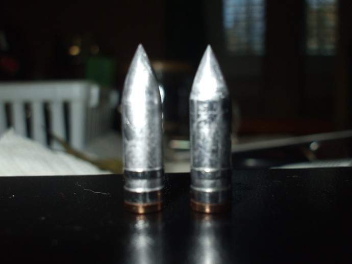

Bullet on left is not bumped. Nose measures .2205 and bands measure .2265.
Bullet on right is bumped 3/4 turn inward of adjusting bolt. Bore ride section after bumping now measures .2205 the full length of bore ride section and bands measure .2275.
Alloy is 13-14 bhn.
Sorry about poor picture quality

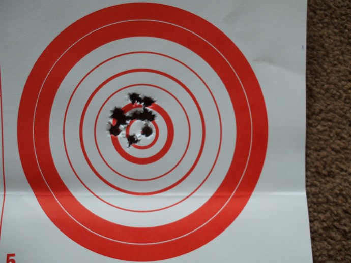

The bump die was well worth the effort. Average group sizing  has been reduced by half. This 10 shot group was shot using 15 grains of old long cut IMR 4198.

Here is an example of bullets that were not bumped using 14 grains of same powder.

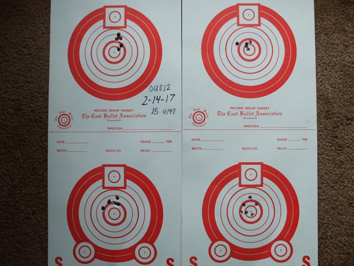

Here is the same 15 gr load of 4198... velocity is around 2000fps.
25 rounds fired without cleaning using 45-45-10 lube.
These bullets were bumped or compressed  about .030". More compression seems to shoot better. One full revolution of top bolt in die equals .055"

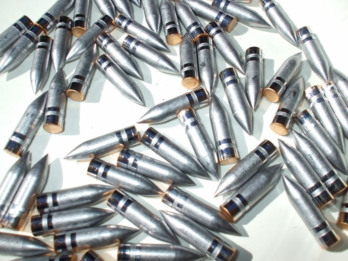

I let the bullets harden a couple days before sizing and bumping. Gas check on bullet was seated square then sized to .2259. Diameter will increase to  diameter of die +.0004 after bumping. Here are bullets before being bumped. Bullets will age harden to 15 bhn after two weeks.
As cast bullets are a slip fit into .220 diameter die...

OU812 posted this 16 February 2017
Thanks, The mold is NOE's 3 cavity brass version that has  been shortened to make gas check shank shorter. I made the bullet shank shorter so that maybe the long 80 grain bullet would shoot in the 1-12 twist Remington barrel. Bullet seems to shoot regardless of what you read (Greenhill formula was written for canon projectiles  during an earlier war... per Veral Smith)
The Gator gas check snaps on then it is pressed into bottom drive band and squared before sizing. I made a special bullet holder mounted in my RCBS Lubamatic to do this. The holder is made from K&S .250” OD brass tubing...with a .221 Inner Dimension. Tube was filled with JB Weld and allowed to cure with wax coated bullet inserted up to first drive band.
Gator gas checks are about .001" thicker than the Hornaday checks and for some reason more difficult to size nose first in the Lee sizer. So first I must "crimp on"  base first In RCBS lubramatic using .227 die. Then final sizing is done nose first in the .226 LEE sizer before inserting bullet into bump die. I think the extra thickness of the 22 cal. Gator checks works better than the thinner Hornadays
I cast these bullets between 700-750 degrees...spout flow rate should be on the low side. Casting fins at nose were removed with thumb nail. Very easy to cast these bullets with practice.
I have been using NOE's matching aluminum nose punch during bumping and it seems to be holding up pretty good, but will compress and settle a little at first.
