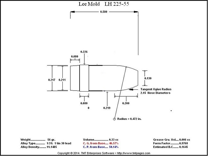

 Recently I bought a Lee 225-55-RF GC two cavity mold with the idea of using it in my .218B as well as my other center fire 22's. And after casting some in my standard alloy of WW + some type for fill out, I found that the nose is way too large for the bore of the B as well as the other center fire 22's that I have,- .223". They need to be a max of .219” or maybe .220 so that I could size the nose down. with a NOE .219” nose bushing.

R. Dupraz:  Good to read of your success with the NOE 60gr.  As to the Lee 225-55-rf , I just measured a few of mine and the noses measure .219. This is with an alloy BHN of 16 to 18. As with most Lee moulds it's kind of the luck of the draw. some being favorites and others trash bin material.  This bullet being fairly short doesn't reach lands in most of my 22s and so works well for my plinking rounds.  Gp

This is how mine measured in 30/1.
