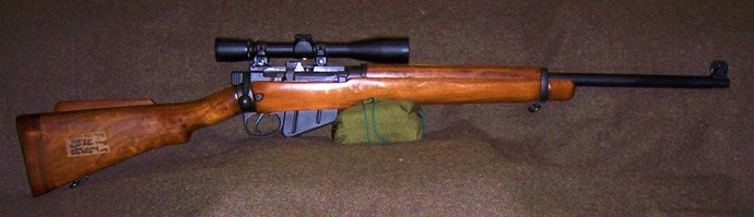

The “new” #4 mk 1/2 that I got 25yrs ago is still working on the same 60 Winchester reworked  factory loads & 50 new R-P unprimed brass.  Don't know what I'll use when my last can of SR4759 is gone.
Ed Harris posted this 02 April 2017

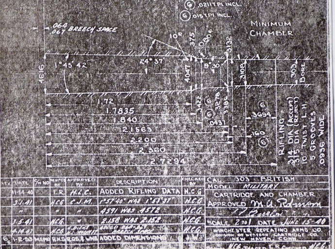

I solved my .303 problems by rebarreling with proper chamber and getting rid of the “trench” tolerances.  I had a reamer ground to the WRA print provided to me by Bill Learned who was one of the Winchester engineers producing ammo for the Lend-Lease program.  I neck size only and am using WRA and Norma brass which seems to last forever in the proper chamber.

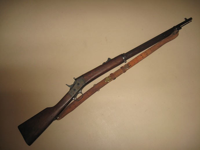

I use that technique when loading for a 1902 Remington 7x57 Rolling Block . Run the empty case over a .30 expanding plug, Then successively sizing the neck in a 7x57 die until the case just chambers. Size no more than that after each firing. Creates a false shoulder.
