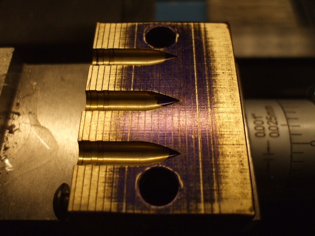

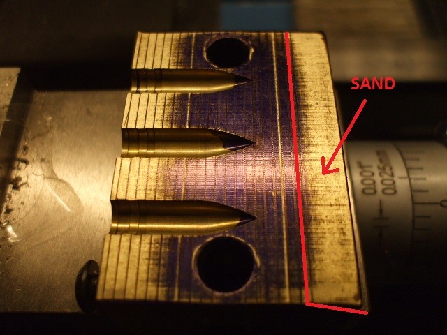

I was wondering why nose diameter was larger than advertised and finning was excessive. I believe that over tightening of handle pivot bolts caused this NOE brass mould to bow. Over tightening causes handle gap to spread and cause bow or not being flat. I will repair
To expose high areas, I applied Dykem layout die (black marker) to female mould face then sanded on flat surface using 800 grit paper.
Sand female halve only and be extra careful not to sand away vent lines from top halve area of mould face.
Fitting bullets to a “new barrel” can be a problem if bore ride section is too large or alloy is too hard.
OU812 posted this 22 April 2017
Sand down bottom of mould face or cut away bottom portion to close gap between halves. And do not tighten hinge bolts too tight.

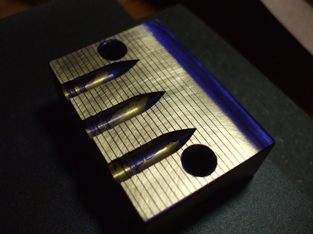

Gary, I applied die to one side of mould halve then clamped halves together. This is result
What can I do to reduce gap?

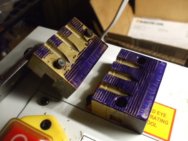

OU812
Your method is so different than mine and your ink marks aren't as conclusive because you use so much ink and it looks like you did it wet with ink. Try  it like I do.
1) clean all ink off.
2) put mold block handles back on blocks.
3) open handles and put ink lightly on one block face and allow to dry.
4) While squeezing handles with light hand pressure  tap the handle extension bar in the mold blocks lightly with a plastic or leather mallet.
5) open handles and look to see how the ink has been disturbed with optical magnification 6-10x
6) the pre-contacting areas will be indicated by disturbed ink
7) reduce the indicated areas
8) Clean off ink and repeat steps 3-7 until you get even full surface contact of the mold halves. Cleaning each time before applying new ink is necessary for true readings.
It is a very methodical thing to do. If you have a friend that is an old machinist, ask him to demonstrate “spotting in with indicator ink” He has done it thousands of times.
There is a number of machinists on this forum, I hope one will chime in too.
 You have a very small amount of metal to remove, likely .001 and it is delicate. If you don't have the hands for this send it back to the maker with YOUR handles and ink marks.

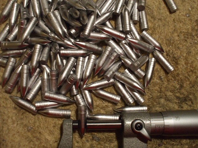

Bullets now have WAY less finning and measure very close to smaller advertised bore ride diameter of .219 (actually.2188-.2192). Alloy is about 14.5 bhn.
Before fixing mould  the as cast bore ride section measured larger .2205 diameter with same alloy. These large bullets would not fit tighter throat of new barrel.
These can be bumped larger if need be   “i"
