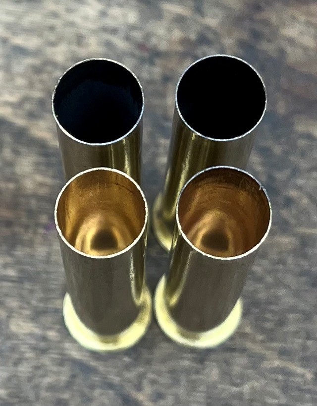

After firing the cartridges, I noticed the bore was immaculate, unlike all the residue left from the IMR-3031. The cartridge cases were bright and shiny like new ones. This is very impressive performance with Shooters World MP Black and the N.O.E. bullet. By the way, I used the Starline 2.125" (long) 38-55 cases.
Here is a shot of the cases after firing. The cruddy ones are IMR-3031 and the shiny ones are MP Black.

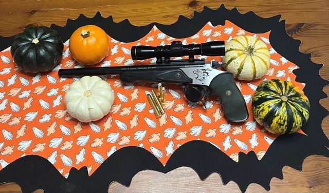

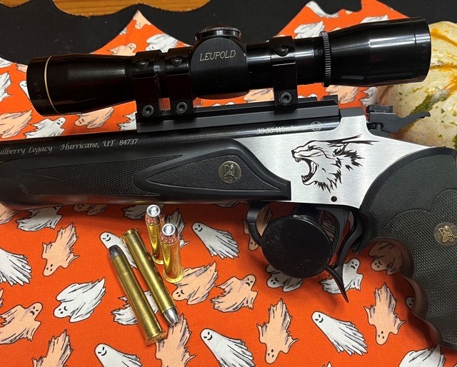

The T/C Rig
I am very happy with this Bullberry barrel and its performance with the N.O.E. 379-235-HP bullet and especially the performance of the combination with Shooters World MP Black propellant.
