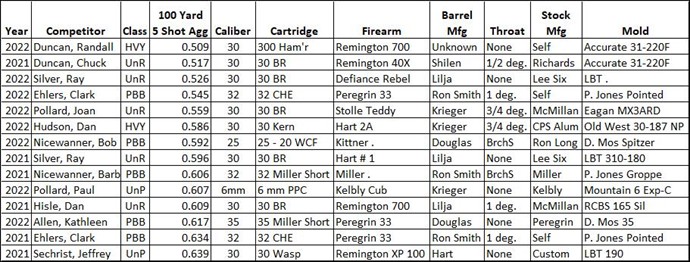

This is coming from someone who won't live long enough to know half of what you all know so take this with a grain of salt.  Shooting on my range, in conditions I choose to shoot in, I hit a wall.
I'm picking at the minutia around molds, bullet to bore fit, casting methods, bullet base, neck tension etc and I can't say there's been a major breakthrough.  I'll be the first to grant you that all of the above (as well as reloading equipment, bench equipment, bench discipline) are a prerequisite to shooting small 5 shot aggregates.  In fact without the basics you won't even break an aggregate under an inch.
This is a data grab from the last two Nationals.  What's listed is the top 15 14 five shot 100 yard aggregates for the years 2021 and 2022.  These 15 aggregates were shot by 12 different shooters.  I've jumped to the conclusion that all 12 have their equipment and technique sorted out and that they are serious competitors trying really hard.  All but Chuck Duncan (Hunter Class) were shooting custom stocks and custom barrels which makes sense.  I expect smaller groups from custom rigs.
Bullet selection in cast competition (setting aside PB) is everything from conical to spritzer to borerider.  Which also makes sense.  Bullet to bore fit will be different for every reamer.  I won't even ask how Chuck broke a half inch agg with a factory rifle.

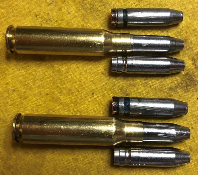

While I was still in Illinois and before we both joined the CBA, Ed Doonan built a bullet recovery box. It was eight feet long and two feet square filled with oiled sawdust. The entry was foam rubber in the shape of a funnel like a fish trap using foam rubber. This was soon modified to add a cut every two feet to insert waxed paper to see how far the bullet traveled.
 The rifling marks are interesting as they show skidding as the bullet enters the rifling, gas cutting, powder kernel marks on a plain base bullet, etc. The only bullets that made the entire eight foot length were: .30-'06 AP, .30-'06 National Match, and .45-70 500 grain round-nose.
This is a worthy endeavor but you'll spend all day recovering and little shooting. As more people joined us to shoot at Windhill, we lost interest in the box.
