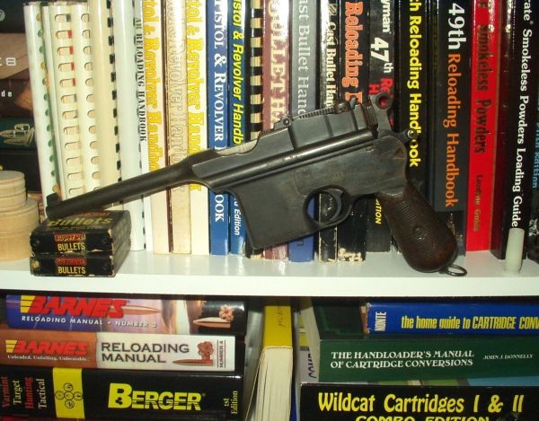

Finally found the 308227 to try with my Astra 900 / .30 Mauser. I've had this pistol for several years, but never shot any cast bullets in it. Let me know if you had any experience with this pistol and combo.

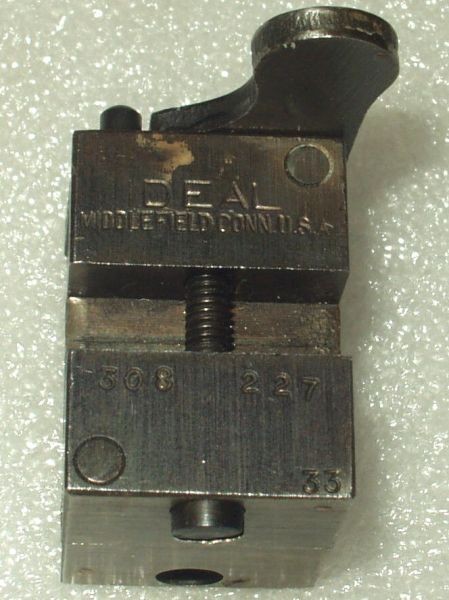

Here's the mold.

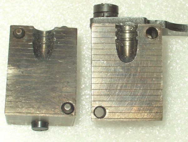

One more.

The rules don't change regardless of your combo. You will have to determine if the mold will cast bullets in a suitable diameter to fit the firearm you have.
The perfect fit will pass an ink test with a dummy load and show if the bullet is the largest diameter that will easily chamber. Ink on the bullet should show slide marks from chambering, but still chamber easily. Any smaller of a bullet diameter will have reduced accuracy potential for any cast bullet/firearm combo.
