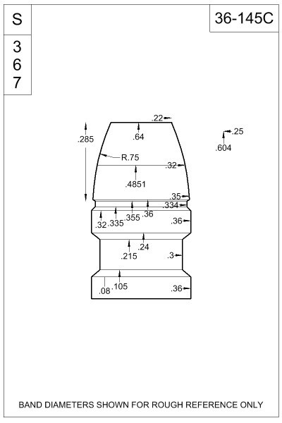

Just for fun, I want to buy a Remington style black powder 36 cal. revolver and shoot a wad cutter cast from a custom mold. I envision the bullet to be 0.5 to 0.6 inches long and shot at target velocities. 38 specials have a twist rate of around 181/2 and shoot well. Most BP revolvers have a twist rate of 30 which is suitable for balls. Dixie Gun Works lists a Remington Navy with a twist rate of 18. My question is: which twist rate is best for a wadcutter and or conical bullet? Cove

The bullets that load well into BP revolvers are heeled bullets with a short bearing surface and a substantial heel under band diameter to start the bullet. A wad-cutter will have a long bearing area in comparison and if it is NOT heeled it will be very difficult to load straight into the chambers. You have more considerations than twist selecting a bullet for BP revolvers. The old and valid rule of thumb for BP revolver bullets is that the bullet that is closest to the weight of a round ball will shoot better than a heavier one is pretty sensible.
Heeled bullets also shoot more accurately with a wad. So, a short bullet is important for 2 reasons.
Consider this SWC mold , it can be ordered to your specification diameter and cut with a heel for BP revolver loading and a nose shortened to flat:
A heeled tumble lube design wadcutter would also be a good selection. Accurate will make molds to your design and weight for a specific alloy.....pure lead is the best choice for BP revolvers.
Gary- Thanks for your input. Will look up 37100N. I see your point, but isn't the reason BP revolvers have 1 in 30 twist is the fact that a round ball is short and easy to stabilize. Using the twist formula for BP in Joe Brennans book, it appears that a 1 in 30 twist will stabilize a bullet around 1/2 inch long, but that is for rifles. Also, if 1 in 30 is adequate, why do they make a revolver with 1 in 18? I mentioned that this was going to be a "Fun Project", at this point I'm in the confused stage. I plan on loading using a custom made loading stand and will have the bullet made so that it has a slight taper at the base to help align it at loading. Thus being the case, bullet length may be limited to room left in the cylinder after powder and wad have been inserted. To be continued-Cove

S&W .38 Special barrels are 18-3/4” twist and stabilize 1/2” long, 148-grain HBWC bullets well at 700 fps and above. The .38 Long Colt used a 148-grain heeled bullet with .375” driving band ahead of the case and .360” diameter heel inside the case. A similar heeled bullet like Accurate 36-145C, having ample lube capacity for black powder, but made with its with base band of diameter to allow snug finger starting in the cylinder and the nose diameter a full .380” to cut a ring of lead in seating like a .36 Maxi-Ball will work fine. Cast bullets 1:40 tin lead.
