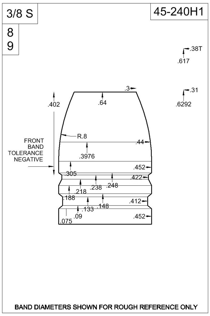

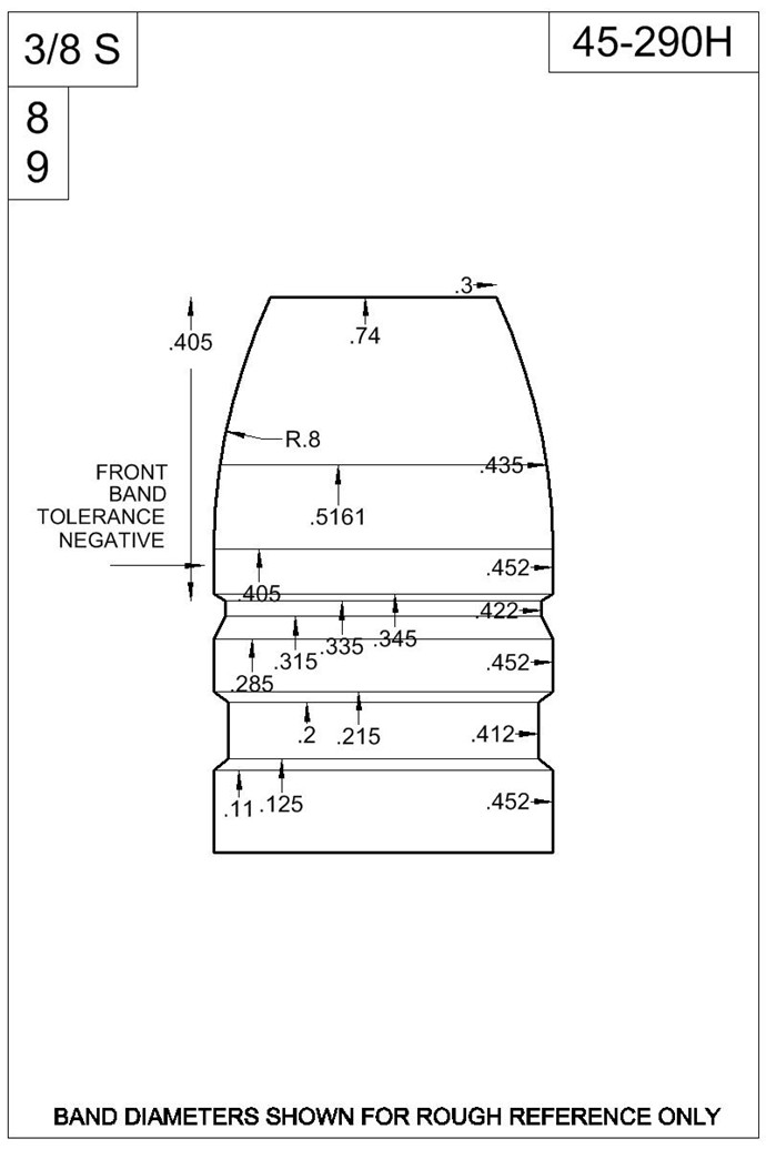

FWIW I use the Accurate 45-290H in my NMB with 7.2 grains of Bullseye and with my Bowen Rough Country rear sight bottomed out it shoots center of mass at 100 yards on the 12” gong with the 290 when the revolver is zeroed at 50 yards with the 45-240H1 with the same 7.2 grain charge of Bullseye, which is my “go to” load.
