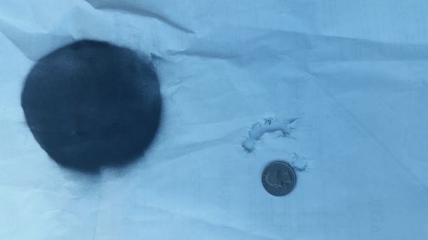

I've been shooting 55g with a .490 ball with .015 patch in a lyman gp hunter 1-32 with good luck.my  5 shot groups are between 1.25 and 2.25 inch at 50 yards.I can shoot 40 shots with no cleaning and loading  remains easy.<size= ><size=I got the powder fot $10 per pound on closeout.I'm buying 10 more pounds! >

Great you finally tried BMZ. I think it is wonderful stuff. It did just as well for me the first time and continues too. My Lyman GP shoots so clean with BMZ that it puts fun into shooting that rifle at a level I never had before. Really Clean shooting stuff.

I was surprised that a report by writer toby bridges said it only kept “hunting accuracy ” for 4 or so shots before cleaning was  needed with patched ball.it's my feeling he never tried more than 4 shots.

I ran 6 strings of 5 shots through a chronograph with BMZ and the Lee 250 gr REAL. ES was 4 on average. That speaks very loud and supported Alliant's claim that BMZ has the lowest ES of any muzzle loading propellant. I also won 2 second places in our ML Postal matches with BMZ and my Lyman GP.
Your result and mine agree. The BMZ is definitely a match grade propellant for me.
our Lyman rifles do have an advantage in my opinion. The bore finish on Lyman rifles is superb. That helps too.  My inexpensive Traditions flintlock rifle kit gun also shoots as well as my Lyman with BMZ.
I do have a CVA kit built percussion Mountain rifle with a coarse finish bore. The CVA will shoot better when more shots break it in better. I have only fired that CVA 10 times at 50 yards with BMZ. It doesn't group as well as my other rifles but has “Hunting Accuracy” The CVA just needs to be shot more to break it in. That is different from my Traditions Flint that shot fine the first time tried new with BMZ.

I shot a bit over 40 shots yesterday offhand with no cleaning and again accuracy seem to hold up fine. I'm also using CCI number 11 non magnum primers. Ignition is instant
