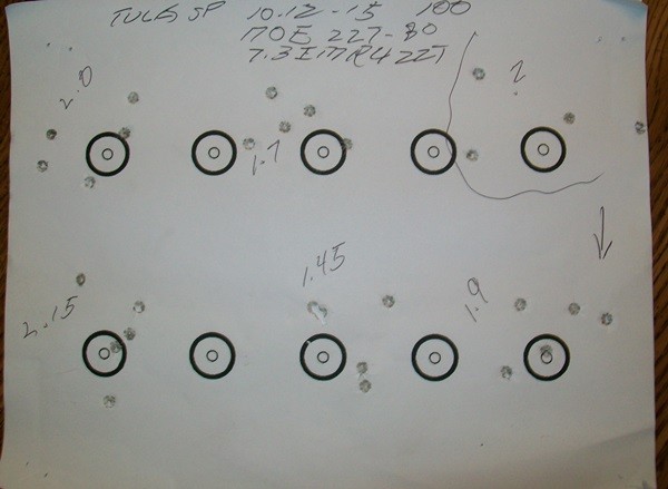

joeb33050 posted this 12 October 2015
Same loads at 50 yards, 7/IMR4227, Tula SP
The other bullet
At 100 yards, 7.3 grains of powder, 225415 = no groups. The NOE bullet shot better, Didn't load the 646M.

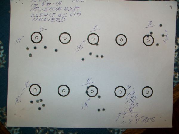

joeb33050 posted this 21 October 2015
Now at 100 yards I tried the 3 bullets with 8 and 9 grains of IMR4227. All with gas checks, some with the groove above the gas check lubed with Lyman Moly and sized .225x", some unsized and LLA. It seemed that the unsized/gc/LLA bullets shot a little better, but group averages were well above 2". 10/20/15 the last loaded 225415 gc sized lyman moly with 10/IMR4227 shot the first 5 all over the paper, so I shot all 30 aimed at 1 target. 30 in 5.2", 25 in 2.375", 20 in 2”
The 225646M, unsized/gc/LLA shot 5 groups into 1.86” average with 10/IMR4227.
And the 225415 gc/unsized/LLA averaged 1.44” for 5, 5 shot, 100 yard groups. These aren't great groups, but they are the best targets I've ever shot with cast bullets in a 223. I suspect that crimping the neck/mouth in the Lee Collet Die may be the trick, that some bullets set back on chambering and others don't, =ing big groups. Or it could be my new eyesight. At any rate, the 2 5 shot 5 group targets were the 106th and 107th target records with this gun, and the first time that  it's shown any hope at all.

Congratulations.  I shot 415s (which worked better than anything else at the time) out of a good Sako for several years and 1.5” was the best I could average.  Bill has done better with his Swift and 415s but 1.44” for five consequetive groups impresses me. You have a great squirrel load.
Why don't you check out your theory that crimping is helping because  bullets may be being pushed back upon chambering by chambering an (or several) uncrimped dummy rounds and measuring them after extraction to see?

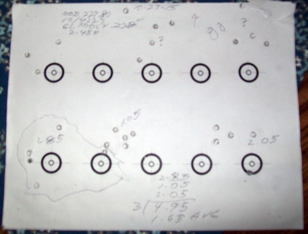

joeb33050 posted this 28 October 2015
And on October 27 it all went to pieces. NOE 227-80, only found 3 groups, avg 1.65"-10/IMR4227 225415, 5 groups, 2.980” avg - 10.5/IMR4227 225646M, 5 groups, 2.24” avg, - 10.5/IMR4227
225646M
