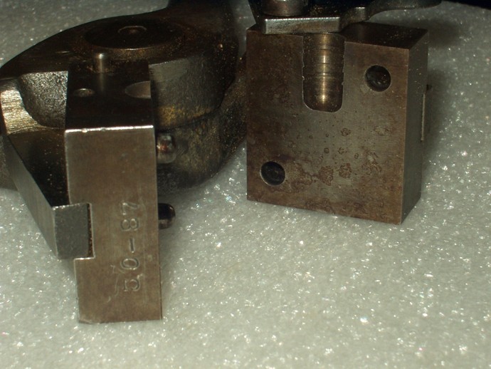

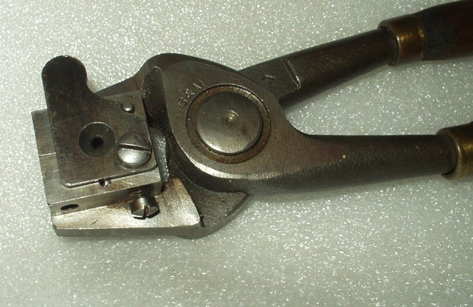

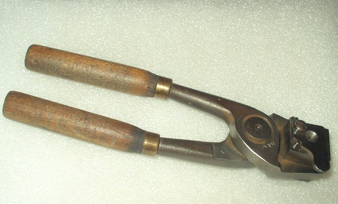

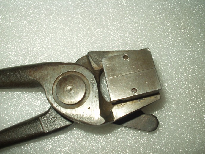

I received my first B&M mold today. It was purchased from a non-caster who got it at an estate sale. At first I wasn't sure it had nickel mold blocks. The appearance was lighter in color than iron, but still tarnished from age. A magnet stuck with authority, but a quick check confirmed my suspicion that nickel is magnetic. I had my suspicions that it was a very early mold form the single marking, 30-87 on one block and the B&M on the handles. From my research it appears that the nickel molds were made only for a few years of production, possibly between 1924-27. The bullet style is typical of their blunt nosed designs. As soon as I get to the pot I will cast some to see what the actual diameter and weight is. It is in great shape and as they say, built like a tank.

 Yes it is a real B&M nickel mould and in the 32 pistol caliber. Congratulations!
norm posted this 27 January 2017
Dave, That is not a B&M sprue plate. B&M sprue plates that I have are full width of the blocks,1/4 inch thick and stick over the far end of the mold.

I kinda figure that, just because it looks funny. I will look for a parts mold to get one from or make one. The mold was $25, so a replacement sprue plate is not such a big deal. But thanks for confirming my suspicions. The only two references I have are two original B&M handbooks from the early forties. There is just not much info about them, that I can find anyway.
