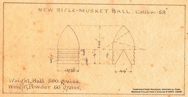

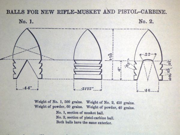

Ed Harris posted this 28 June 2015
My W.J. Jeffery, and an Isaac Hollis & Sons 3-band rifle I had did have about 0.005” "choke” near the muzzle.  I am told this was intended to ease loading with a fouled barrel.  RIfling in both of these was 5 equal width lands and grooves.  I could not tell if they were gain twist, if so it was very gradual.  Either rifle was capable of 4-inch, ten-shot groups at 100 yards. Then as now, bullet “fit” was critical.  Best grouping was obtained using the dilute tin/lead alloy such that bullet required loading with a short starter and mallet. Once engraved they would ram home easily.  Many N-SSA fellows sized their bullets to permit easier loading, but I opted for better precision and a lower rate of fire, which worked for me.   Here is a better drawing of the original .58 Minie bullet. The pistol-carbine bullet has a thinner skirt, larger base cavity and lighter weight, more closely resembling the current Lyman “Old Style.” I am told by N-SSA competitors that Lyman adopted the carbine bullet profile to reduce recoil and to improve accuracy with the lighter charges favored by target shooters. That would make sense.
