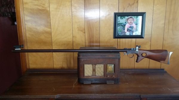

Hi everybody, Picked up this rifle at the muzzleloader ron-day-voo in Friendship, IN. It is purportedly a “crossed stick” rifle made by Butch Matthews. Caliber .40 with a 40” barrel, however, I am perplexed by the twist. It's a round ball gun with a 1-50 twist. Anybody got any info?

1:48 and slower to 1:72 twist is a standard that is accepted as the normal range for round balls. You don't have a bad twist for round balls at 1:50.
Thanks, that's a relief. My round ball throwers ( archaic CVA & Lyman rifles) were 1-60 plus.
The smaller the bore the faster the twist for RB. 1-48 is standard for .32-.40cal. Slower from there up.
Thanks Jeff, I think that's where I got confused. The fiftys and fifty-four that I had all had twists in the 1:60 range. I remember that when CVA went from 1:66 to 1:48 (back in the pleistocene) it was called a compromise because it could shoot roundballs or maxis. I mistakenly thought that that's what happened here.

Okaay... Now that I know where Canal Fulton is I need to know a little something about the match. Got a website? You know, some people would balk at competing with a rifle that they haven't even test fired yet. Speaking of test firing, after some preliminary measurement I'm thinking .390 ball with .015 patch over 50 grains of FFFg, anybody got any input? Also, I need a “sweet spot” to rest the sticks. I'm thinking of starting at the exact middle of the barrel, hopefully doubling the harmonic frequency. Any thoughts?

With a 1/50 twist you may not need 50gr of 3F. I have a custom gun being built with in 40 cal with a 1/57 twist for shoot 45-50gr of powder. I will be shooting falling targets with it and thought a little extra power would help the 40 cal. A charge of 40-45gr will more than likely be the most accurate but you never know until you burn some powder!

Sounds good to me. I'll start with 40gr and work my way up.
Both my .40cal Colerain barrels (1 -48) shoot tightest with a decent charge; 40-50gr Swiss 3Fg. I suspect with a .390 ball you will need more than a .015 patch. I shoot a .395 and .018 patch.
