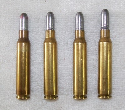

It took a while to get this figured out. I loaded etc several times to get hers-several times at various OALs.NEI 71 grain bullets from John Alexander. The noses measure .220"-.2206". o nose goes in the muzzle, before or after loading in a case.Left  OAL = 2.008", this is the AL for the ctgs I loaded, the ctg goes in and out of the gun easily without de-bulleting. This is my definition of correct START OAL. Start here, then make a little shorter and test.Next, 2nd and 3rd ctgs. OAL = 2.230” Here there is some resistance chambering, the first band is hitting something and they don't de-bullet on removal. This is about as long as I'd load, more comfortable shorter-but-I know that first band is making a seal. There is NO trace of land marks on the noses.Right ctg, OAL = 2.294. This is as long as I can make them without de-bulleting and get them in the gun-with a lot of force. I'd never load this long. There are clear land marks on the nose, hard to measure but ~ .160” long land marks.So, there's no land / nose touching/marking at any comfortable OAL. I'm still surprised at the throat wear in ~ 2000 shots. I ASSUME that when new the nose would have been marked much further back, that the bbl was ~ the same size throat and muzzle.
frnkeore posted this 13 December 2013
I don't understand on the last two, how you don't have land marks @ 2.230 and then load out .064 to 2.294 and get .160 of land marking?

joeb33050 posted this 13 December 2013
frnkeore wrote: I don't understand on the last two, how you don't have land marks @ 2.230 and then load out .064 to 2.294 and get .160 of land marking?
My mistake-2.023", not 2.230". I can't edit my post?

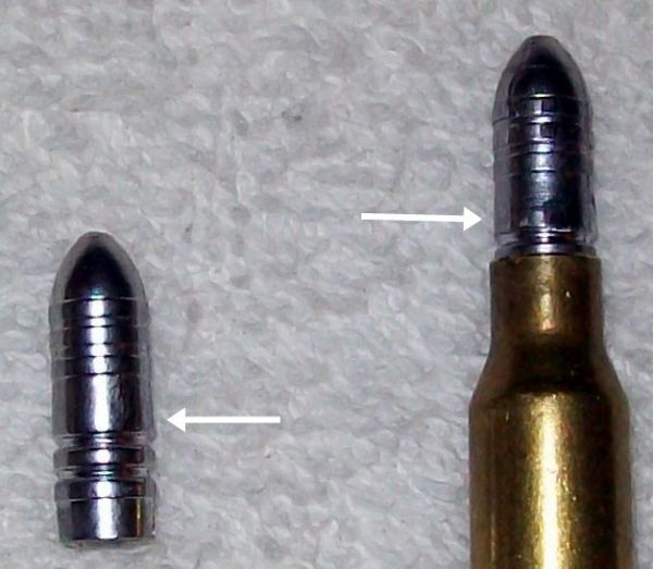

The 225646 mold was modified by Eric O. at the Hollowpoint mold service. He took out the 2 front grease grooves and enlarged their positions to ~.221” My OAL is 2.253", where the front band/taper-see the arrows-is mashed into something, thre is some nose/nose band engraving, and it takes a bit of force to close the bolt and the ctg doesn't de-bullet. Hope to shoot Wed.
