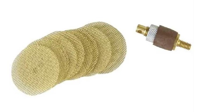

Perhaps a Lewis Lead removal tool would help scour this area?

I believe the carbon buildup is from all the soft loads typical with cast bullets that I'm shooting (1650 - 1720fps).  Lately I've been playing with a bunch of powders while I was working with primers and flash holes.  As I said, the bore is never a problem and it comes out clean with no lead buildup.  Ugly bore though. Tool chattering marks from stem to stern.  I think Aaron might have something about using the Lewis lead remove tool.  Looks like Brownell has it ($20) sized for 30 cal as well as 35, 44 and 50.
This tool would have come in handy for me a couple years back when I first started out shooting accuracy.  Back in the 90's I was taught not to oversize the bullets so I was pushing .311, .310 bullets into a freebore that was only .3085. That left a ramp of lead buildup that was a devil and a half to clean out.  This was on my first ever "intended to shoot cast accurately" rifle about mid 2020 if I remember right.  Prior to this I had been shooting surplus military plus 30-30's, 35's.  All of them had voluptuous freebores.
I usually buy 9mm brushes (oversized like John says) and use a pistol length Dewey rod.  With a touch of blue Lock-Tite I can rotate it clockwise and counter clockwise to wear down the buildup.  Before I clean next time I think I'll soak that area before the regular bore cleaning.  By the time I finish the barrel cleaning the crud might brush out easier.  Below is what the Lewis cleaner looks like.  It has a common 8/32 thread.  Not a bad idea at all.  I still run a couple passes through the barrel with 0000 steel wool if I ever do see any lead. Thanks, Bill.

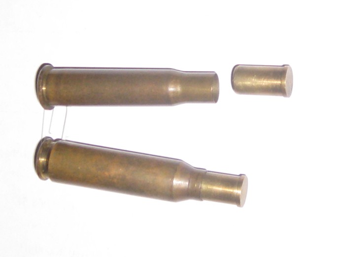

Bill - I thought your idea of using the longer neck of a fired .30-06 to scrape the gunk was spot on. This isn't far off the rust removal trick of using a sharpened brass key and turps to shift an exterior rust patch.
You could take that idea a bit further, by making a long neck .308 case out of a .30-06. This would need to be full chamber (neck) length, but not overlength so the bolt could still close on it. The case neck would need to be expanded to a tight sliding fit in the chamber neck. With a nice square mouth trim and no deburring it should scrape nicely with a bit of to and fro on the bolt.
Alternately, for cast bullets at least, you could use longer cases. This is how I make my chamber length gauges so I know "how long". The flange on the end of the plunger is full chamber neck diameter. My Ruger .308 chamber length was 2.025". My .30-30s are 2.120" and 2.150", much longer than available brass, unless I make it from .38-55.

I had forgotten about the chamber length gage.  In the recent past I was always using chore boy wrapped around a brush. But it seemed inefficient to me since it wasn't a flat surface scrubbing a flat spot.  Always messing with the ball of copper to try to get it to clean up.  Always thinking that there should be a simple tool that would fit the neck of the chamber that could be used to scrub out the junk.   Something like the Lewis tool but specific to cleaning the end of the chamber where the freebore starts.
I think pre-soaking the area is a must, at least for carbon buildup.  With my 30-06 case in the .308 chamber I drilled out the primer pocket and put a 8/32 screw through it to mount it on a pistol cleaning rod.  Guess there are a few ways to approach this.  If its lead like barra thinks that's a whole different animal.  Don't throw me in jail for this but I've been desperate enough that I almost went to using an acetone and hyd peroxide patch to soak the area when I had a lead build up.  Thanks, Bill.
