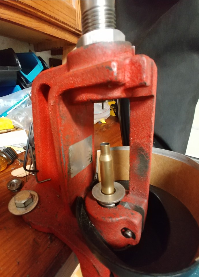

The Lee Collet 308W neck sizer works perfectly to NS 7.62x54R cases.  Just get a larger washer to slip over the case after the case is in the shell holder.  That washer "spacer" then corrects for the difference in case length from case head to front of shoulder between the two cases.
Adjust the die body in the press to give the amount of neck tension for the bullet diameter used.  The neck does not have to be sized solidly against the mandrel.
