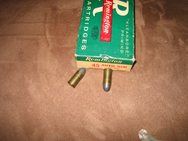

In digging through my ammo, I located both a box of Remington and Peters Factory Soft Point 38-40 loads that I believe are from the late 50's early 60's- it is my intention to chronograph these in both New Service and NMBH.  Don't know when it will happen, but will post when done.
Also tried to find out some more info on the US Cartridge Co 38-40 loads chronographed and reported above.  One of the collector sites had  pictorial list of 22 ammo boxes by US Cartridge Co. another site notes that Winchester took over USCCo in 1926 and subsequent boxes were not marked Lowell Mass.  The 22 site noted that the Light blue half boxes with US in a circle were used from approximately 1910 into the 1920's - given that my New Service dates from 1923, it seems logical.  I hope this might help with dating these loads, which were with the revolver when obtained in the late 50's.
I did find a site that showed Remington ammo boxes and the changes over the years with some dating information.  All of these sites are cartridge collector locations.
Al

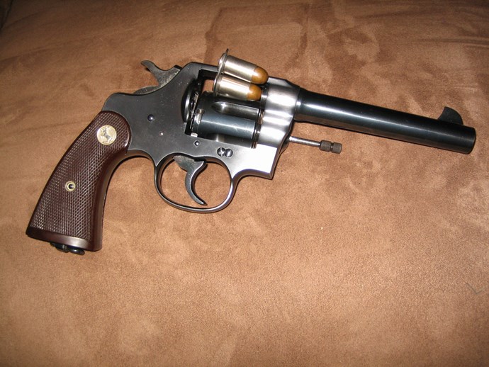

ALYMAN#1 posted this 29 March 2019
38-40 New Service with original grips and S. D. Myers holster
3840NS
US Cartridge Co probably from 1920's 180? gr lead using LESMOK powder
USC3840
Peters 3840 180 JSP
P3840
Western 180 gr JSP from 60''s
West3840
Rem 3840 180 JSP from 1961
R3840
New service front sight as filed down years ago - works with most of the reloads I have used.
FSNS
Hope these first efforts are OK - still have several things to work out navigating the process.
Al

Just curious - does a 1917 colt DA 45 fit into this thread?  Was digging in the safe and got out Colt and S&W 1917's and took them to the range for some Smoke time   If not too far astray will put together some info and possibly some pics if I can remember how  The Colt looks just like all the above including my own 38-40 above (towards the top), made in 1919 from Colt site, excellent condition with horrible bore and throats, looks like sandpaper, shot some 45 ACP and AR loads with 250 gr Speer and H&G 22 cast - sights required about half of front sight above the frame with these loads.  Took no data just plinking -  need something to make a project of.
Will pursue, if someone so desires.
Al
Ed Harris posted this 31 December 2020
M1917 Colt DA .45 absolutely!  Lots of them out there, great guns.  Please post results with yours.

ALYMAN#1 posted this 10 January 2021
Info on Colt DA 45 (ACP) on hand Since 1957 -58 as follows:  Bore 0.444-0.445, Groove  0.451-0.452, chambers 0.455-0.456, Cylinder pass 0.007, hold 0.008.  Bore and chambers are frosted from early use with corrosive ammo, otherwise in excellent condition with a tight action and reasonably heavy trigger pull.
On hand is a partial box of Remington 45 Auto Rim cartridges with 230 grain lead bullets, probably from 1962 -63.  Also recorded below is data from Federal ball Lot FC 1950 FC 61 headstamp.
Some velocities recorded at 10 feet are as follows:
                                                            Colt DA Army            Colt 1911A1 from 1943 US
RP 45 AR 230 gr Lot E185                  709 FPS
FC 61 ball                                             748 FPS               767 FPS
Speer 250 SWC/5.5 Unique                  669 FPS
0.454 dia LLA  LD #11
H&G 22 250 gr RNFP 0.454 sized      812 FPS
/lubed/5.5 grs HP 38 LD #8
25 yard accuracy results were miserable due to my own handicaps and are not included - will try again another day.  My best accuracy was with a Ruger convertible 45 acp with a scope on it, so I have hope for better results.
XXX - Please note, That after researching loads in multiple sources, that the 250 H&G mold load with 5.5 grs of HP 38 exceeds most recent loading recommendations - it was the only reference I could find for a 250 gr bullet in what I had on hand under max recommendations, the 1998 Midway 45 ACP Loadmap pamphlet.  The load did fine in all the revolvers I tried S&W 1917, 25-2, Colt 1917 and Ruger NMBH 45 convertible which did record 878 fps from a 7 1/2 inch barrel.  Also note that all the above have chamber throats of 0.455" or above.  Am currently revisiting this load and will probably reserve the remaining rounds for the NMBH.  The 250 grain bullets were the only ones on hand that came close to fitting the 0.455 chambers and loaded rounds chambered satisfactorily.

It is time to dust this thread off with my Official Carhartt Barn Coat Pocket Blaster.
  • John F.
Ed Harris posted this 15 January 2023
Sorry, unable to edit from my Android phone or add pictures. Imagine a 1915 Canadian marked New Service .455 with 2-3/4" barrel.
  • John F.
