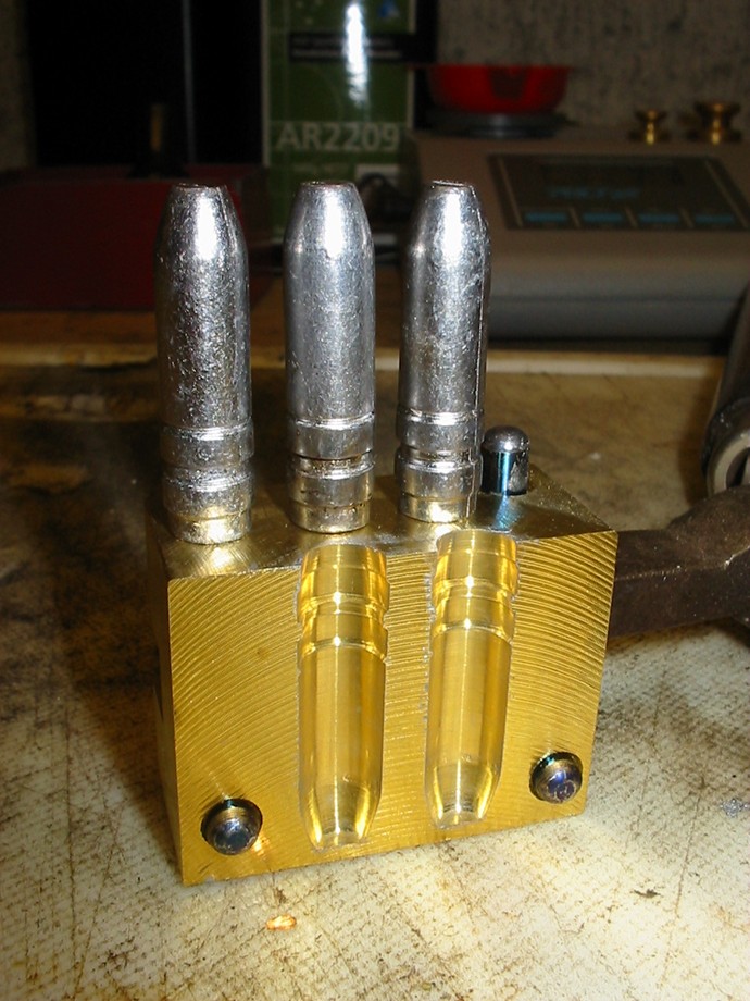

JeffinNZ posted this 11 October 2019
CBE 314 220 that I cast.  I was heat treating WW alloy but suspect that was not necessary.  Need to test that.  Casts at .316 so tend to shoot as big as I can.
SkinnerD posted this 11 October 2019
Mmm nice mould!
