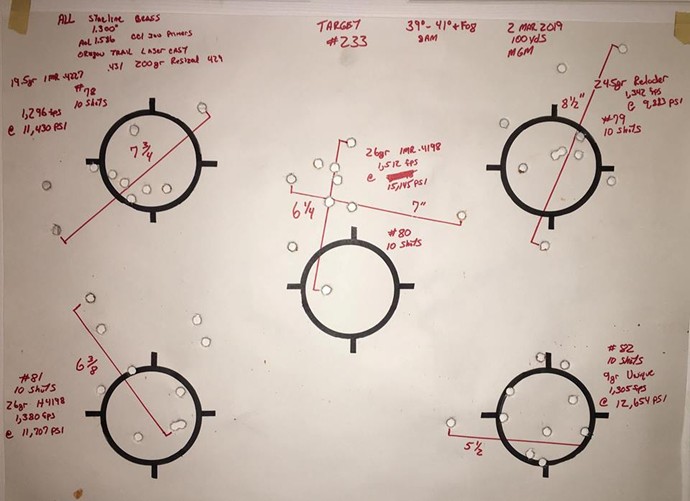

This mornings results.
My results may not be accurate but are consistent.
Target #233
Tests #78 thru #82

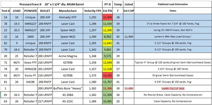

19.5gr IMR-4227...1,296fps @ 11,430 psi
24.5gr Reloder 7...1,342fps @ 9,883 psi
26gr IMR-4198 (case capacity)...1,512fps @ 15,145 psi
26gr H4198...1,380fps @ 11,707 psi
9gr Unique...1,305fps @ 12,654 psi
As we all expected, Unique is a great powder but an accidental double charge can be disastrous! What can also be seen is pressures created with bullets not listed in handloading manuals for a specific cartridge. The 200gr Hornady XTP is a very popular bullet that quite a few 44-40 guys load up for hunting loads. Some even load hotter than shown. Not bad at all for strong action rifles and can be very iffy for the Winchester 73' and revolvers.
I did notice, however, that Hornady's 10th edition manual does list 9.8gr of Unique and the 200gr XTP for Ruger BlackHawk.
My plan was to load for 1,300fps with a popular 200gr hard cast LRNFP Magma type bullet.

First, is is easy to see why folks have such good success loading Re7 and H4198.
Second, for anyone who though IMR4198 and H4198 were the same or similar, think again.
Good report.
Bryan Austin posted this 04 March 2019
Two observations here. First, is is easy to see why folks have such good success loading Re7 and H4198. Second, for anyone who though IMR4198 and H4198 were the same or similar, think again. Good report.
Yeap, just because the two powders are back to back on burn rate certainly doesn't mean they burn the same!!!
Reloder 7 by far is the best powder for case capacity or near case capacity loads when using bullets that desire to sit on top of the powder.

Somewhat of a conclusion to my thinking. Sometimes the best way to get answers is to post conflicting information rather than simply asking a question.
So......
Recap
In 1894 Winchester first offered their smokeless powder for the 44–40. The new boxes had a Red label specifically marked for the Winchester 73 but NOT FOR PISTOLS. This new smokeless powder gave velocities to 1,300fps but produced high pressures. Dupont #2 powder was used. Dupont #2 was quickly replaced with Sharpshooter which was designed to be used in black powder firearms and produced less chamber pressures than black powder. Sharpshooter was used all the way up to 1948. However, Dupont #2 was not discontinued until 1926. In 1913 SR80 (Sporting Rifle 80) was introduced. SR80 was also used for High Velocity rounds in the 44–40. Published loads of 18gr of SR80 with a 200gr JSP produced 1,625fps. Even today, SAAMI list the 44–40 as a rifle cartridge.
Black Powder Testings
I have tested 40gr/w of Swiss FFG black powder with a .18″-.20″ compression with original early semi-balloonhead unheadstamped 1880’s brass and produced 1,373fps @ 14,285psi. Same loads using Goex FFG produced 1,356fps @ 12,648psi. The same loads using Starline Brass with .21″ compression produced only 10,000psi. The same loads used in post 1890’s semi-balloonhead mixed headstamped cases produced 10,500psi.
Early Smokeless Powder Thoughts
I am lead to believe that early 44–40 black powder cartridges produced around 14,000psi while early Dupont #2 smokeless powder produced even higher pressures which is why they should not be used in early black powder frame revolvers. I am lead to believe that when Winchester switched to Sharpshooter powder, the pressures dropped to the 11,000psi mark and is what set the standards of today. My testings have been consistent but I can not dig out actual historical pressures. I doubt I ever will.
My replicated High Velocity loads produce in the 18,000psi range which leads me to believe that this would be close to 22,000cup according to Lyman’s 49th handloading manuals load data and Winchester HV data.
Sounds reasonable but who knows...???
