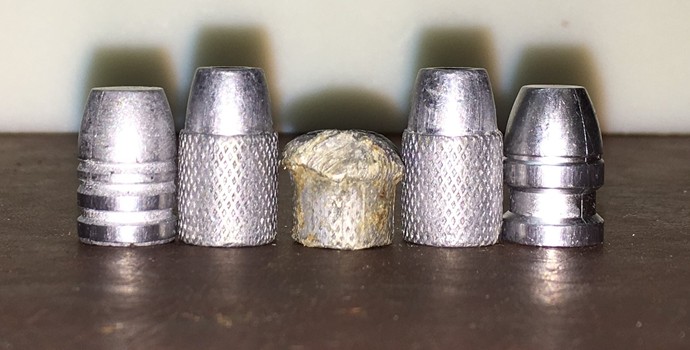

Larry Gibson posted this 11 October 2019
Note savvyjack is shooting the swaged bullets at a higher velocity with accuracy and no leading.  He is doing that out of a rifle which is why.  Out of a revolver with it's attendant long cylinder throat, the cylinder/barrel gap and then swaging down in the forcing cone will not allow such higher end performance w/o leading.
