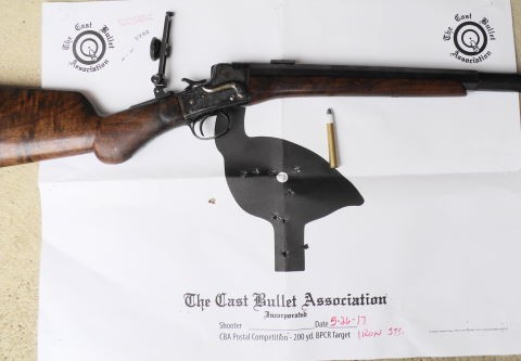

picture of one of the targets a few years ago, only one I kept
Aaron posted this 15 July 2024
I am using the Buffalo Arms #9 Onion Skin paper at .0018". The math says by bullets should be at .3722 when wrapped, but they come out at .3711". I don't think the rifle minds the peach fuzz difference.  I, like you, realize the value of BP in the 38-55 (38-50). They just love that propellant. The lever actions could care less and They digest Buffalo Rifle just fine. Like I said, hunting accuracy below 150 yards.
That's some good shooting on that target above. NICE rifle too!
Tom Acheson posted this 15 July 2024
Chuck,
I started that Postal in 2013 (I think).
That is a very nice looking target.....great shooting....8 out of 10!

4060may posted this 15 July 2024
I am shooting this year just to say I did, May, June, didn't do good, but not bad for Iron Sights, getting hard to see, working on my 82nd time around the sun
