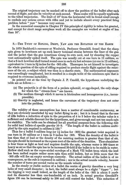

Here's a table showing how stability varies as V and Twist.
joeb33050 posted this 28 November 2018
SF < 1.0  Bullet is not stabilized
SF > 1.0  Bullet is marginally stabilized
SF > 1.3 = Bullet is fully stabilized
SF > 1.5 = Bullet is maximally stabilized

Charlie Dell's formula:
(3.5 x MV1/2 x Caliber2) / Bullet Length = Required Twist Rate
Note the MV squared, twist rqd and stability are affected little by V.100 fps ^1/2 = 10, 900 fps ^1/2 = 30; 1600 fps^1/2 = 40, etc.
