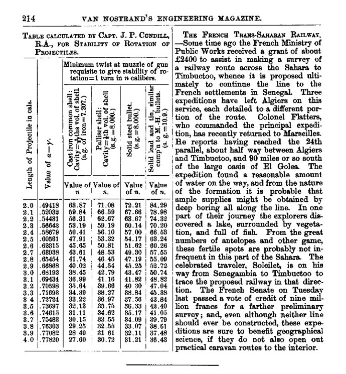

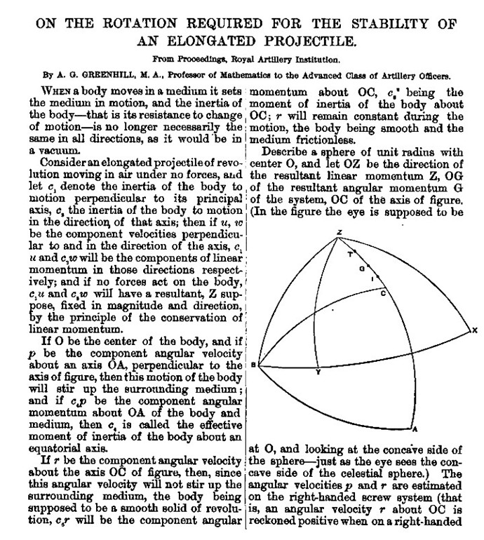

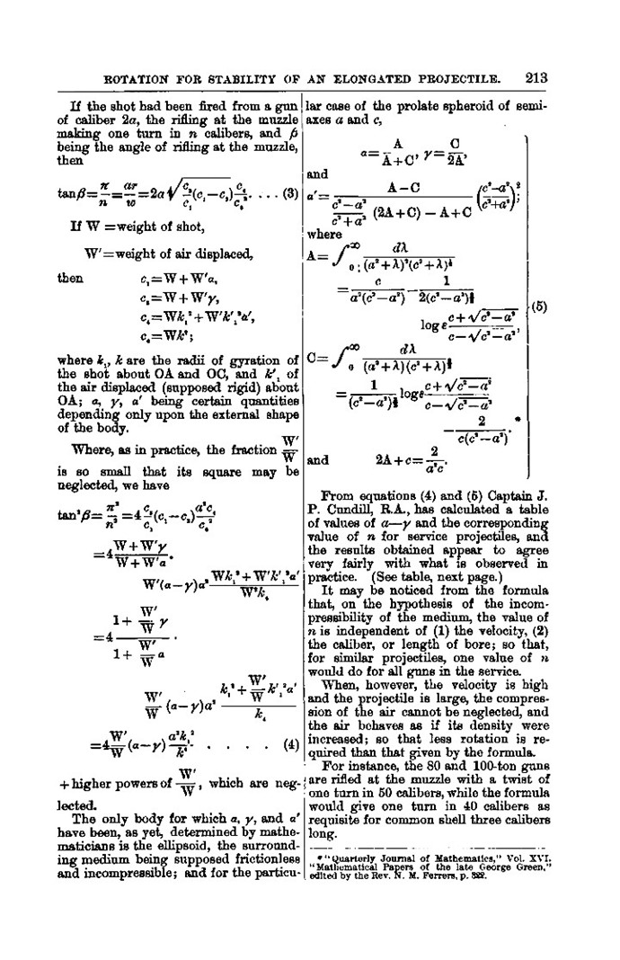

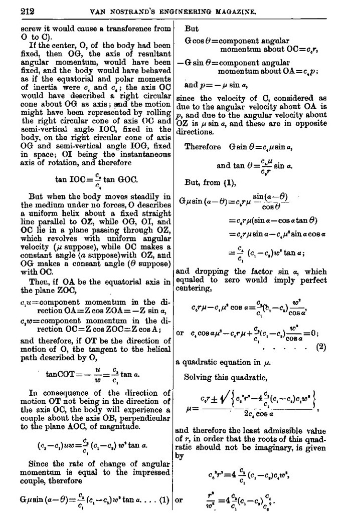

  Greenhill is NOT obsolete, is not empirically derived, the 150 constant is NOT wrong. What you have is people taking the SIMPLIFIED Greenhill (which is kind of an Executive Summary/For Dummies version) and trying to apply it to everything without understanding what the constant represents. That 150 was the result of solving the full mathematical development as applied to the .30-40 Krag/.303 British cartridge (about identical ballistics)  -220 Grain RN .30 cal 1.35" long at 2000 fps with a density of 10.9 gm/ml, etc. The further you change things from this, the more you need to change to a different constant.So, no the 150 doesn't give the best twist for your 350 grain semi-wadcutter from a .50 muzzleloader OR for a 120 grain boattail VLD HP from your .240 Weatherby.
You need to know what goes into the constant and how a specific characteristic is applied in order to rationally change it. See the article on here  https://www.fulton-armory.com/faqs/AR-FAQs/ARTwists.html  for a full discussion. Take an aspirin first, it's tricky.

Greenhill never fails.
I have available to any and all an Excel workbook that allows one to calculate twist numbers for 4 different twist formulas, including Greenhill. You have but to ask.
Greenhill never fails, and is the only formula with a SINGLE solution.
Greenhill never fails to bring forth an abundance of opinion little of which is from those who have read Greenhill's work.
A 10" twist is my recommendation.
