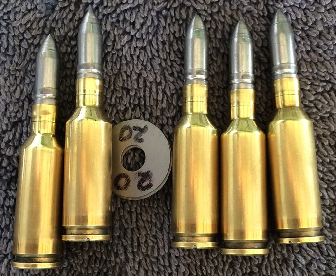

Paul Pollard posted this 12 December 2016
Here are the tumble-lubed bullets ready to shoot. There is no conventional lube at the gas check either.

Paul, Good picture, but those bullet tips look distorted...looks like you sized or seated gas check base first using a nose punch that did not match. Soft alloy ?

The bullets for the national match were only tumble lubed. The lubing is done after all the other bullet sizing, checking, tapering. I heated the bullets with a heat gun, added a drop of liquid carnauba wax and swirled them around in a butter tub. With the heat, they dry really quick. I don't bother standing them on wax paper or anything. They are dry within one minute. They are dry to the touch and don't collect lint. I've been playing with it for a year or so. It hasn't been reliable with the .30 caliber bullets. Advantage? I don't know, except it's not messy. Shoots about the same in the 6ppc. It's ALL an experiment! Isn't it?
OU812,
The gas checks are seated and partially crimped in a spring-loaded die to keep the gas checks tight against the bullet base. The top punch is filled with soft lead to conform to the bullet nose. It's then sized in a .243 Lyman die and press with a top punch. Then it's tapered in a bump die with a light bump. This press pushes the bullet out with another soft lead top punch and stem. So, I guess it's pretty well mangled by the time it gets all the proper sizing and lots of mishandling. Then they're all thrown in a box until it's time to load them. It should only be a 2 MOA bullet, at best.

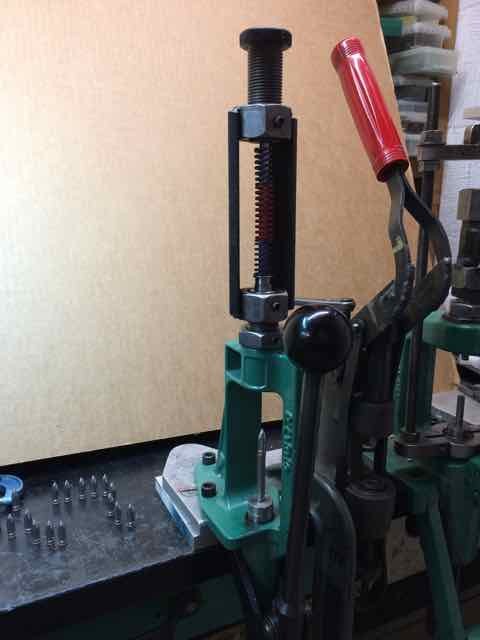

Paul Pollard posted this 26 December 2016
Here's a photo of the spring-loaded gas check seater die. When the ram is raised, the spring loaded top punch pushes against the bullet to seat it in the gas check. When the bullet enters the die, the gas check is crimped to .246. The crimp is finished in the .243 Lyman lubesizer die (the red handle to the right). Almost out of the picture is the taper/bump press which tapers the front band and brings the size back up to .244 on the base. The front band is tapered and the nose is sized to .238.
