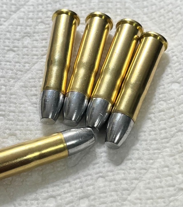

Loaded up some 32-20 Win cartridges today with the mold Accurate made for me by combining two of their other molds with the best features of both. The 31120I bullet is an amazingly accurate bullet in my revolvers and the T/C Contender. I cast these in Lyman #2 alloy and run them around 1000fps in the Uberti 1873 revolvers as well as the Contender. This cartridge is too long for the Cimarron Model-P Jr. revolver which is a tiny little thing.
I dearly love casting for and shooting the 32-20 Win

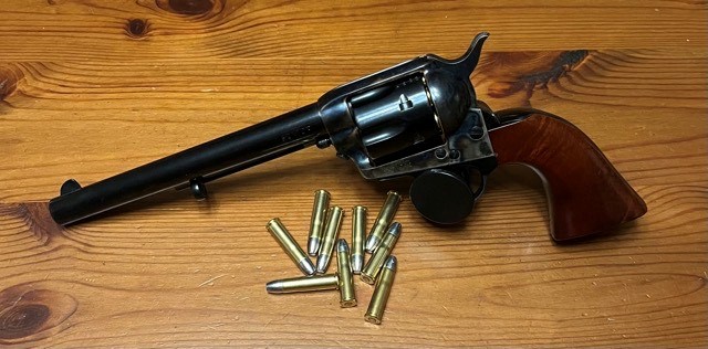

Aaron posted this 04 May 2025
 This is the one I got a while back at DGW. Cattleman

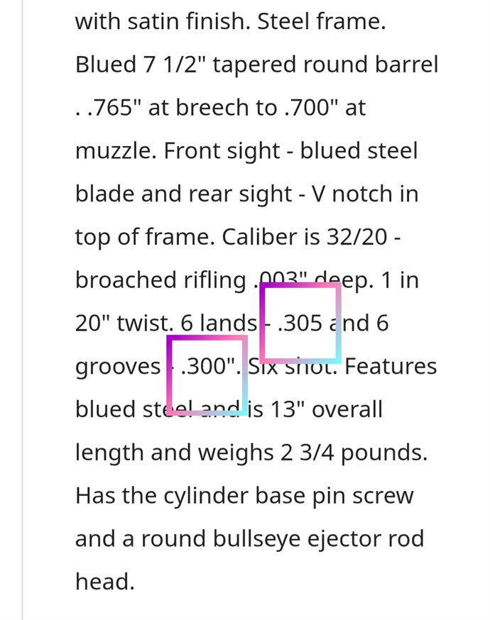

linoww posted this 04 May 2025
these dimensions seem odd? or are they rifling width?
The cylinder mouths are .312". Now the surprising part is a .308 bullet will not fit into the muzzle so the bore is smaller than .308" making the .305" statement realistic. Groove to groove diameter HAS to be bigger than .300" so I think they mean groove depth is .300" making a groove to groove diameter of .311". The Uberti chart on the Cimarron web site shows this Uberti data:
This makes sense and matches the data on the DGW description if you correct their jargon to read "6 grooves - .300" deep."
linoww posted this 05 May 2025
makes sense now.
