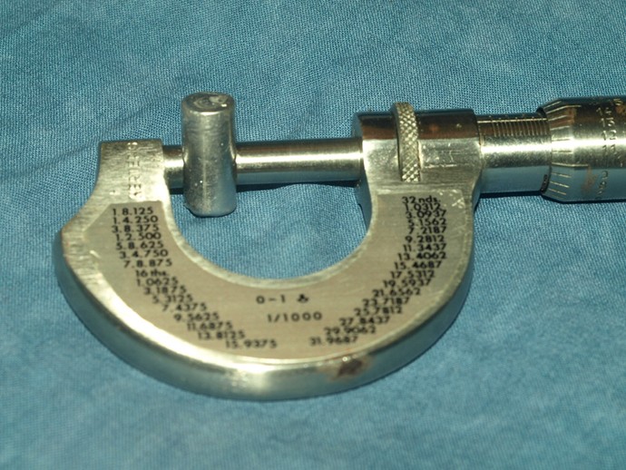

here is an interesting slug mold somebody made ... i bot it to look at it... adjustable length, casts 0.312 from scrap.  mashburn has first dibs if he wants it.  ... oh, nice old Herter's micrometer !!

Yes, I definitely want it.
