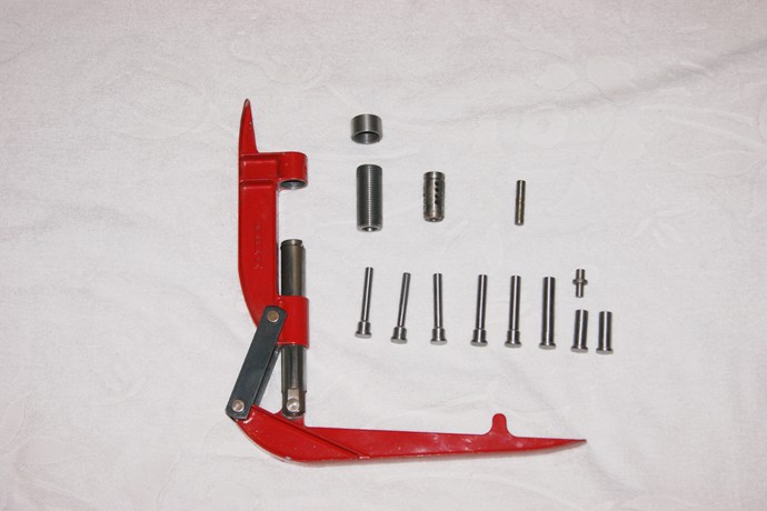

Here's an adapter I had made up to use Lyman dies as push through dies.
Shown are:
Lee Hand Press
Adapter with cap
Lyman Die
Lyman Die pusher (removed)
6.5mm, 7mm, 30 cal, 8mm, 35 cal & 44 cal pushers
Lyman top punch
and 2 top punch adapters
Fouling Shot article to follow.

SierraHunter posted this 08 February 2017
That looks good! I haven't even gotten a chance to mess with this idea yet.
