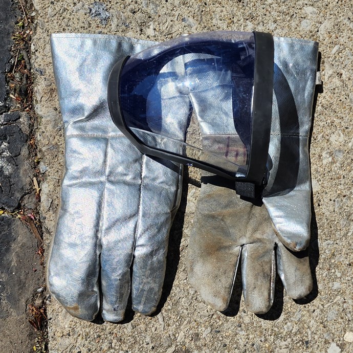

I've been casting for years and never had happen what happened this morning. I just got through casting and went to add a WW ingot to the pot as usual and POP. Lead everywhere. I admit I'm not exactly what you'd call OSHA certified but this was totally unexpected and snapped my pucker string shut. From now on the ingots will sit on the edge of the pot for awhile before dumping them in. Be safe out there because "stuff" (for the the easily offended) happens.

Maybe a vug, air bubble in the ingot? Like you said doodoo occurs. Best to take precautions. I wear a good full face mask and gloves. Better safe than sorry.
surface moisture ????
Who knows. The WWs are kept in the garage and I've been using the batch for some time. It was a little exciting but I didn't get burned and it cleaned up pretty easily so a not too dramatic lesson.
