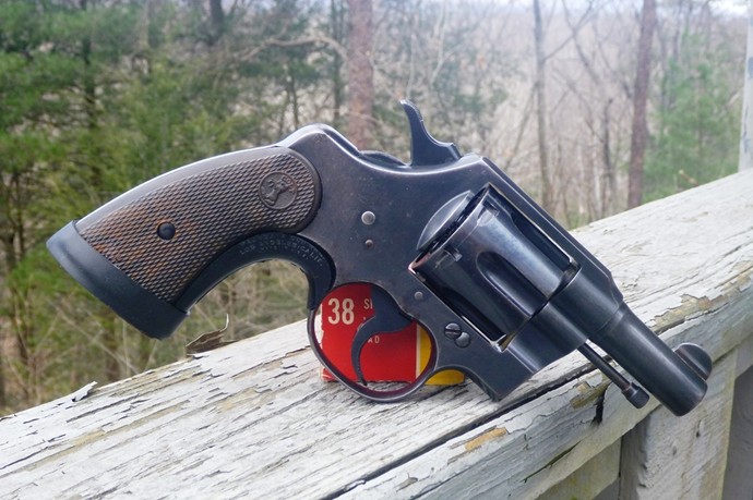

I've gone through the exact same issue with several vintage Colts whose original grips have shrunk. For me the solution has been to buy new, reproduction urethane copies of the original pattern Colt grips from NC Ordnance.
So far I've bought four sets of these for Police Positive, Official Police and New Service and have been well satisfied. They also have synthetic ivory, and what they call Royal Wood, which is a micarta product with realistic wood grain. Pricing runs from $40 up.
https://gungrip.com/coltdoubleactionrevolvergrips-3.aspx
Numrich also still has some original 1940s Colt Official Police take-offs with screw and escutcheons for $17 which fit reasonably on my $240 GunBroker Special cut-down 1939 Official Police "Bubba Snub." The Gearwards "Ranger Band"
https://gearward.com/products/ranger-bands
around the butt is not original, but helps "train" the vintage Pachmayr adapter to conform to the grip frame, and provides a purchase for consistent grip.
