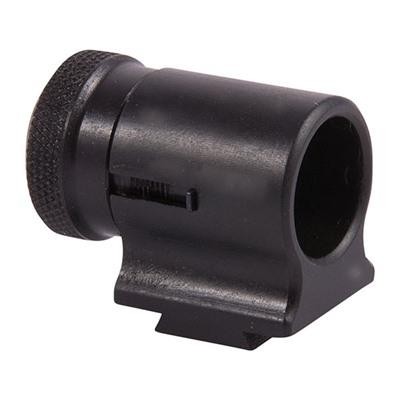

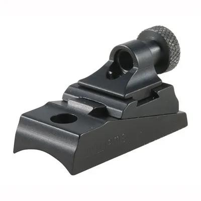

Wm Cook posted this 18 July 2024
I would hate to see your Savage mocked up with a scope.  Kind of goes against my conscience.  I'd do my darnedest to put a receiver sight on it.  But like Ken said, try to find a way to see if a receiver sight would work.
I think the the Savage has that dove tail front sight and if you dig around enough you can find a front sight that'll be the right height for a rear sight that'll look clean and proper.  Going with receiver sights on both ends works for me.  With glasses on I can't see my sights but can see distance.  The near sight doesn't have to be fancy.  I've shot mine with no front sight inserts just to see better.  It works for plinking distances.  My first thought is to see if there is anything available from Skinner that might work for you.  The round receiver might be a problem.  Good luck though, sounds like a worthy project.  Bill C.
