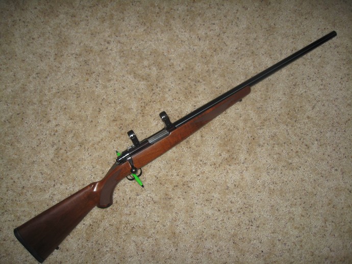

I have a Ruger 77 22 Hornet I have never been happy with. I have a Manson reamer for the standard chamber. I intend to try to set the Ruger barrel back and recut the chamber and see how I like it. Failing joy with that I will put a new barrel on it. Looking at Green Mountain's barrel info there are two options that look like are in my price range.
A center fire blank- 0.220 - 0.224"
http://www.gmriflebarrel.com/rx2214-223-caliber-1-14-twist-chrome-moly-barrel-blank/
Or maybe this 22 RF magnum blank with slightly deeper rifling. 0.219 - 0.224"
http://www.gmriflebarrel.com/22m-blank-22-magnum-raw-gunsmith-edition-blank-1-14/?revpage=2#reviews
Any thoughts for a rifle that will shoot both cast and jacket?

rmrix posted this 01 April 2017
I took the Ruger 7722 hornet to the range for the last time before rechambering it. I wanted to document some groups with factory loads. I have some twenty year old Winchester and Remington loads. Standard loading 45 and 46 grains. I also shot two on my better handloads.
No point is shooting farther than 100y. I want to keep all shots on the paper <G>.
The first to go was the Remington. It shot the first shot wild and settled down into something like 3 inches. This rifle never did do well with the Remington ammo.
The Winchester ammo shot into about 2.5” and to a different point of aim. The Winchester ammo really has been as good (or better as any load I have ever built for this rifle. The Winchester ammo = 2'5"  and I guess that is why I am going to see if I can learn and improve things by setting the barrel back and rechambering.
This has been a 2-1/2 MOA rifle with best handloads and never have I topped the factory Win ammo with what I could put together at the loading bench.
After I get done doing what ever I end up doing to the factory barrel, I will shoot some of this same ammo to contrast and compare.
