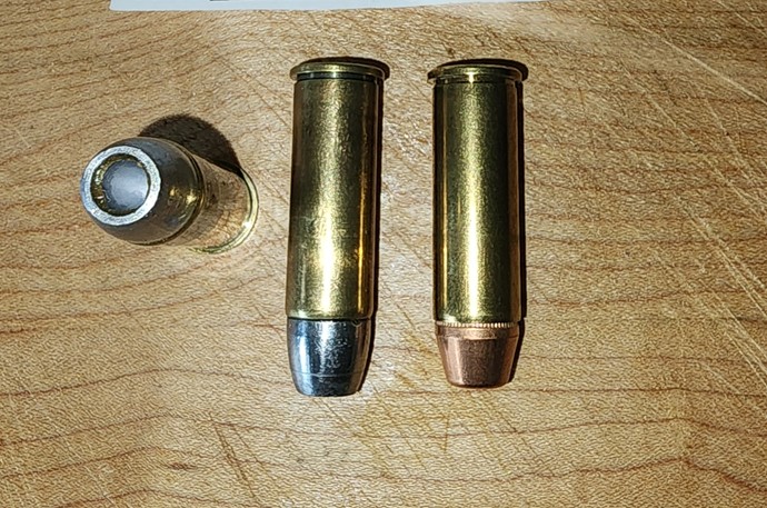

I have an older ruger .44 carbine with the magazine tube. I shot about 30 rounds of cast bullets through it recently. They were 250gr. gc. cast from a 20 to1 mix. They fed and worked the action just fine. Accuracy was ok with 2 and 1/2 inch groups at 50 yards. I still have a lot of herco 2400 powder so used that to load them. What was strange was that I had trouble with feeding and jams with .44 factory jacketed ammo. Maybe cartridge lenght had something to do with it? I will run a bore scope to check the gas port for problems and report back.

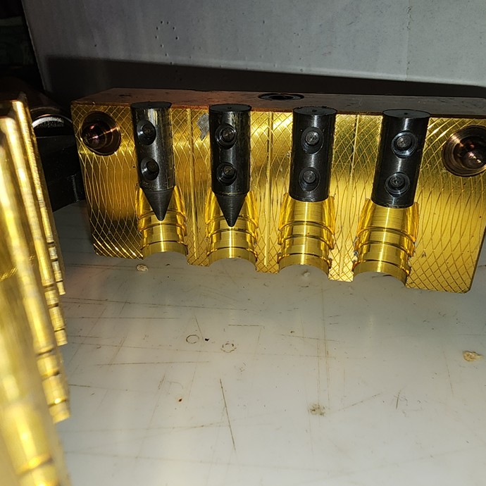

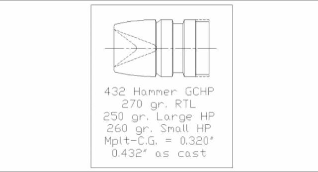

sluggo posted this 23 July 2025
Thanks, the bullet mold is made by MP molds. I am up north fishing. When I get home I will post the mold number.
sluggo posted this 26 July 2025

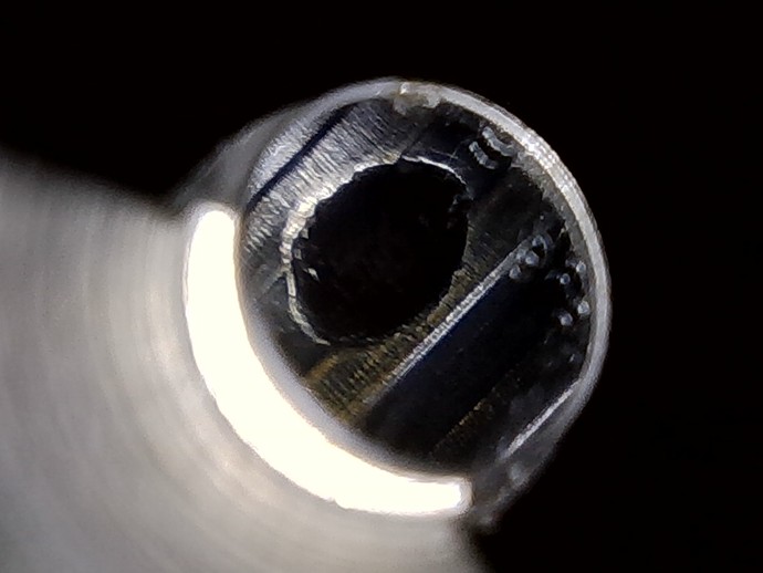

That mold is called the 432 hammer. In hindsight I should have bought the 2 cavity version. The 4 cavity gives you a good workout. I ran the borescope down the Ruger and after 30 gas check cast loads, there might be a bit of smeared lead on the gas port.  I don't think it is too much to worry about.
