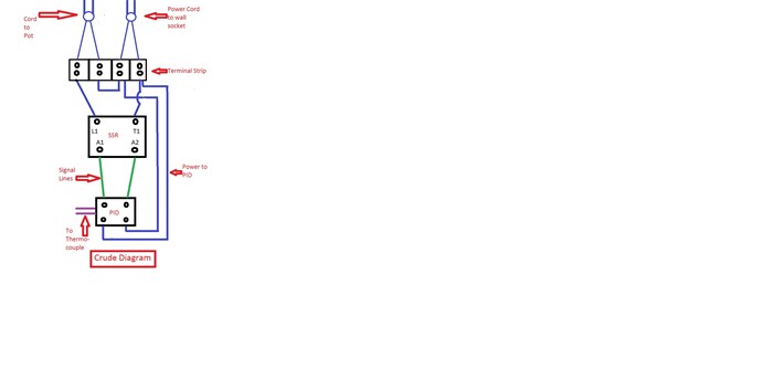

vmwilson posted this 05 March 2017
While I'm thinking about it really is  quite easy to put a unit together yourself.  I've talked a few guys through it via email and a couple of them didn't know any electricity at all.  Enjoyed helping them and would be glad to do so for others also.  Have a number of files to help.  Mine are probably not as pretty as some but they all worked the first time.  Hopefully I'll get a diagram on here that shows just what the working hookup is in basic form.
Mike

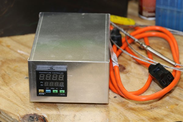

Scearcy posted this 12 March 2017
This is not the REX C100 but this thread inspired me to finally build my own Lead Pot controller with a different, but similar, PID. I offer this picture as incentive to those of you who want one but have been on the fence so to speak. We built 2 of these. The second took almost 4 man hours and cost $75. Adding a switch and/or fuse would add to the cost and complexity but might be features you deem desirable. FWIW
vmwilson posted this 12 March 2017
Looks nice,where you find the nice box?
Mike
Amazon - project box. Cut the square hole with a “Nipper” also obtained at Amazon. All parts ordered on Amazon - everything delivered within 48 hours. The parts list was obtained off a you tube video.
