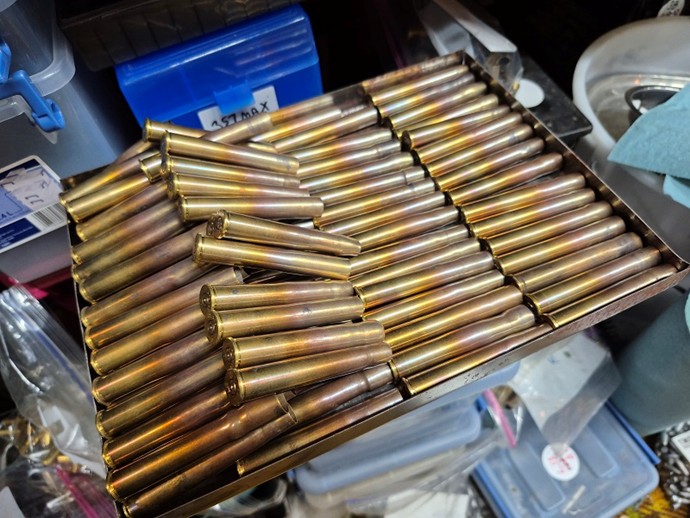

I'm Reforming brass for 44 Shot (3") from 9.3x74R.  (the 44 Shot predates the .410, as the .410 came about around 1911.
Chamber cast indicates a 3" chamber, into which the 9.3x74R case fits well.
I'm using the 444 resigning die to resize (when I get to that stage).
.410 shot cups are good, but shorter than what I would like.
Picture shows brass after annealing.  (I didn't have enough powder to fully expand the brass the first time around.
Ed Harris posted this 11 January 2025
Load a .44-40 card wad over the powder and under the shot cup. This is necessary to avoid powder leaking past the shot cup causing bloopers.

THANKS, Ed!  I had observed the clearance between the case and the shot cup.  I questioned whether or not the thickening of the brass towards the base would be enough.  That would depend on the ID at the top of the powder column - a variable depending on the volume of the powder chosen.
Ed Harris posted this 18 January 2025
In my military M35 aluminum .410 cases I use a .45-70 over powder card and a 1 cm Cheddite waxed felt cusion wad, because the case walls are to thin to work with a conventional plastic shot cup. Same issue with Magtech all-brass.
In reformed RWS 9.3x74R or PPU .303 British cases a .44-40 over powder card works well under the Federal. .410 skeet shot cup.
