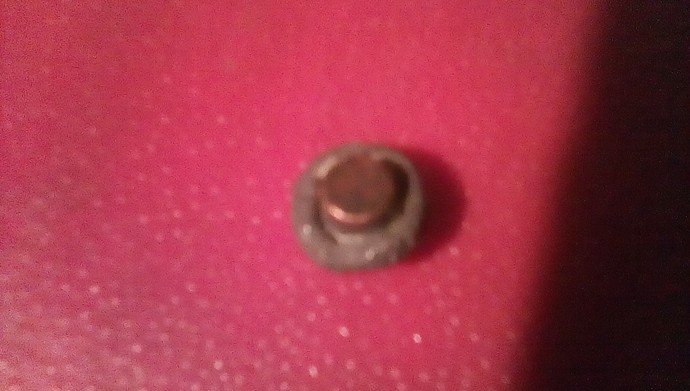

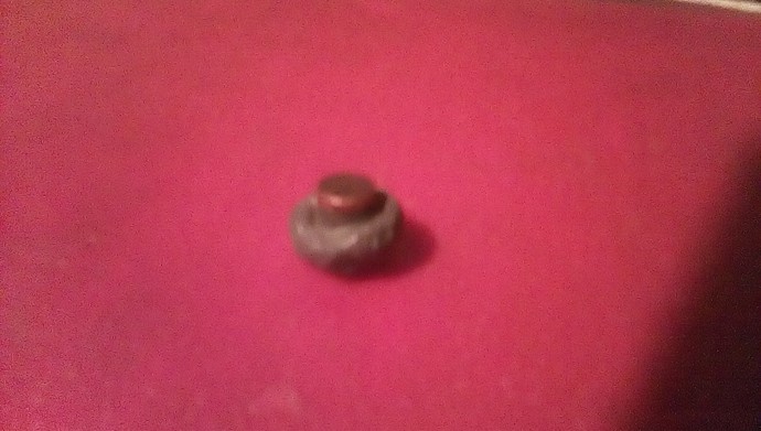

I wanted to recover some fired cast lead bullets, made a water trap, all the gas checks came off. I got lots of advice, decided it must be cooling that caused it. Fired these into sand trap, .227 bullet sized .225 mushroomed to.459, lyman 2, 1490 fps,100 yds.penitration 10 in. no signs of feathers on gas check, TERMINAL!
Cooling, feathers, terminal? WTF What brand gas check is that? Gator or Hornady
Looks like soft alloy. Does gas check grip soft alloy better? Try that test on harder linotype
Lyman 2, should be 15 bhn. Hornady says gas checks are to be seated at .224, mine are .225, but it worked in sand not water. I don,t know,but that is how it turned out for me.
That expansion looks great. I don't see that you need to change a thing. Gp
Yes,expansion is fine, Thank you. However I want better accuracy. I shot today, upped velocity from 1490 in five steps to 1900, still a 1.200 five shot group at 100. Not good enough, a Tikka .223, 1in 8 should do better. I,am going to move up to 25 yds!
