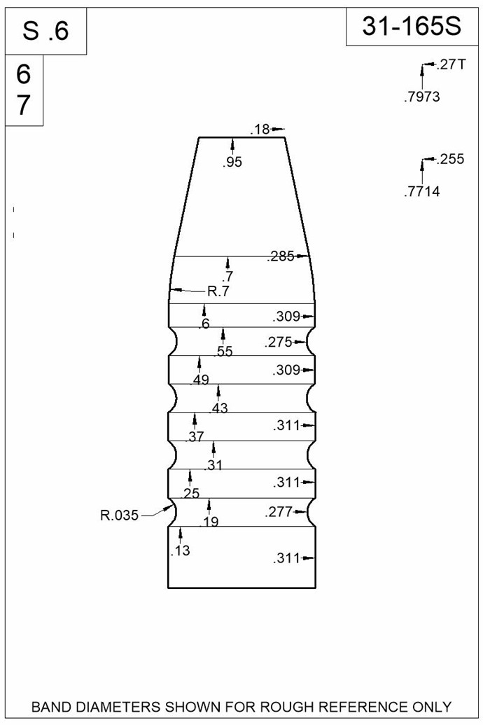

I'm looking for proven powders to try in 06 PB loads. I've tried Unique and Bullseye so far but being old fashioned and not keeping up with recent powder development I was wondering if there are others out there to try. While the gun shot decent with 9 grs of Unique I was getting some tipping with the Accurate Molds 31-200S which is 1.115 long. I did modify and order the same mold so its now .950 long cataloged as the 31-165S and maybe that will help. I know Joe B. Is finding you can get decent accuracy with tipping bullets but I'm sure you can get even better accuracy without the tipping. For lube I was using both thinned liquid alox and Rooster Jacket. They didn't shoot much different up to this point at the low velocity I'm getting but the RJ leaves the barrel totally clean. Its available again from Midway and Buffalo Arms. I'm looking for something that'll shoot at least semi respectably in the hunting rifle class.

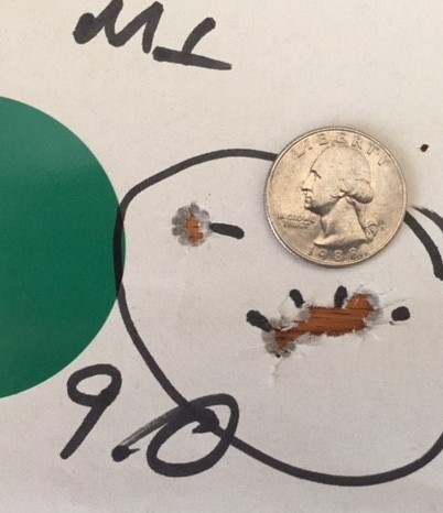

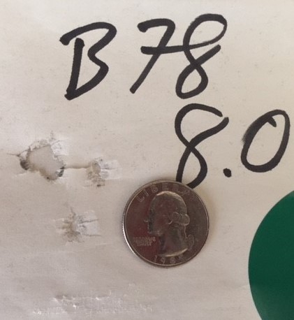

Hi Pat. This last Groundhog Shoot, I used two .30-06 rifles. One a Browning B78, the other, an M1 Garand. Bullet was NOE 310-165gr XCB Plain Base (my mold has one cavity PB and one GC) in #2 Lyman lubed with White Label BAC using Blue Dot powder. The B78 liked 8.0gr, the M1 liked 9.0gr. Both using WLRP and neither had a filler. I should note that these groups were shot with cull bullets used for load development at 50 yds. My score on the shoot was 99 for the M1 and 97 for the B78. Obviously, the 9 grains of BD won't cycle the M1, but they are easy to shoot, and accurate. I also use H4895 in my Garands, but with the heavier Lee C309-200-R bullet. Hope this helps. Ed
BD - B78BD - M1

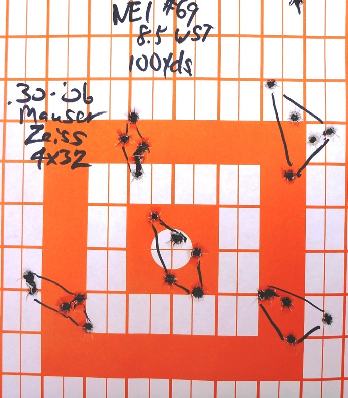

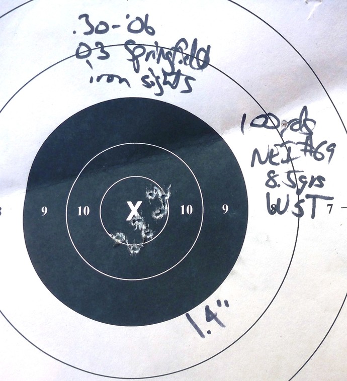

My friends Dick Nearing and Dennis Carlini have good results with in the '06 with 8.5-9.0 grs. of Winchester WST shotgun powder
03 Springfield Iron Sights NEI#69 Pl.Base 8.5 WST
Mauser Sporter NEI#69 Plain Base 8.5 WST 100 yds

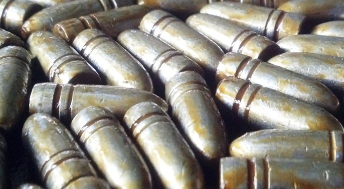

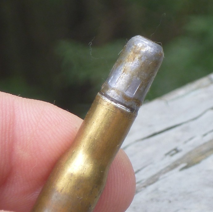

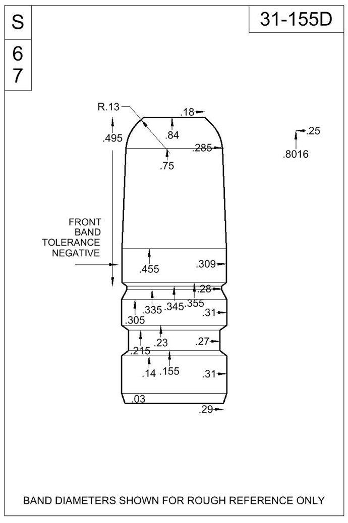

This is what I am using in most of my plain-based .30 cal. loads now, fit in Winchester 94 .30-30 factory chamber.
Not engraved quite as heavily in .30-'06 with longer throat, but still marked. Load 6 grains of Bullseye.
Ed Harris Design for .30-30 - plain based version
Ed Harris posted this 21 July 2018
I want to thank you guys for the replies. Blue Dot I have. WST I'll get. Ed is that the NEI #69 bullet pictured? If so is the nose tapered? Besides the RCBS 165 sil, that just by chance must have fit really well in a gun I had, for some reason known only to God and Harry Pope I've never had much luck with bore ride bullets.
Old Walt Melander NEI #69 has tapered nose, but NEI no longer in business and after Walt died the quality went to garbage.  For a new plainbased mold see Accurate 31-155D.  Also available in GCEd Harris design for 30-30 Win. 171 grain GC

Pat I,
Ed's 31-155D picture shows a good example of the slide fit I mention. That is a nicely fitting to his rifle bullet that will have a stable start due to the fit. Cast bullets that fit will need 1 to 2 pounds more push to chamber than jacketed bullets because of their correct fit and because of the way correct fit causes cast bullets to be burnished on the way into the chamber. Any less fit subtracts accuracy potential. My Lee 185 fits my 03A3 30-06  that well just forward of the case mouth in the chamber and I wouldn't bother to shoot it if it didn't. My bullet also allows the ogive to engage the leade.010" and that enhances stability of fit too.
The taper of the leade contact that Ed's bullet shows is great. Mine show good a contacting slide fit on the first exposed driving band. Both Ed and I achieve a stable start with a contacting bullet fit. Not getting that good of a fit causes many to give up on cast bullets because without that fit your bullets will wobble down the bore and shoot all over the place.
A:though Ed's approach to his fit is different than mine because his bullet design is different, we both achieve the same thing...a verified contacting slide fit on chambering that stabilizes the bullet in the chamber.
My bullets are well marked if I unchamber them. NOTE: an inked bullet on a dummy round is the best way to verify this fit and a fresh inked bullet is only good for a single chamber/unchamber test.

Ed that's a nice bullet and I like the dimensions. I'm having this one cut now. Only change is the front band will be .307. It's big brother the 31-200s I was playing with engraved down to the 3rd band using WWs. I'm gonna put that bullet of yours in my files for future use. Might even bump it up to use in my 38-55 down the road.
