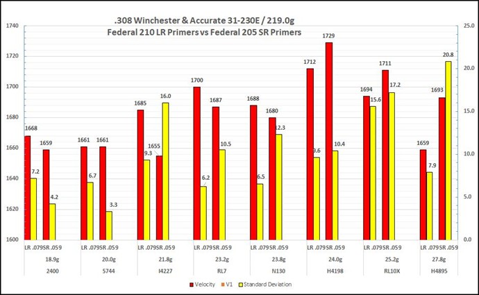

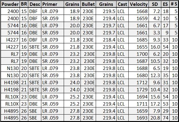

I'm unable to get to the range but I can run velocities and SD's.  This is what I've put together.  I picked up a bottle of N110 and hopefully I'll get to the range and see how some of this shop work works on shooting groups.  Bud also mentioned N340.  David Reiss was working with Ken Johnson / Shooters World a couple years back about producing something close to the 4759.  I've never shot that and always wondered about it.  Thanks, Bill C.

Rick, those are actual numbers but it's out of context since it shows only the velocity and SD for a single powder charge and that can be misleading.  I apologize for that.
Powders that I sampled were judged as either passing or failing based on how velocities laddered up in a progressive fps manner as the charge increased; while still keeping SD’s under 25.  All work was done with a .308 Winchester and either a 210g  or a 220g bullet.
I was looking for the efficient use of the powder charge (velocity) and consistent use of the burned energy (SD) while I worked with independent variables that included SR v LR, powders (Unique to H4985) and flash hole diameters (.059 to .140") .  I’ll post some of the crash and burns later today.  Thanks, Bill C.
