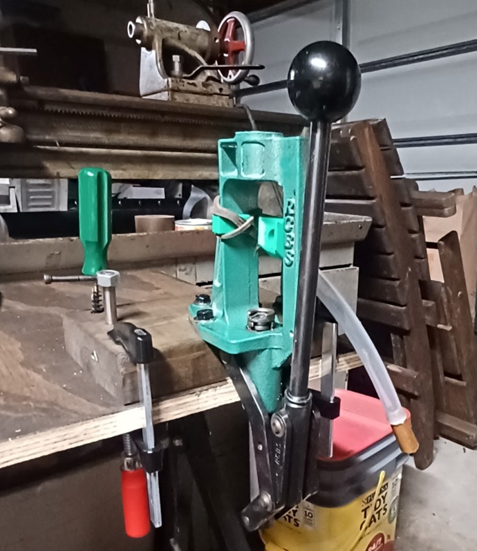

Loading at the range was getting a little tedious to me using a Wilson die and arbor press so I threw this together today. The press itself is a RCBS Partner I had mounted on a Workmate in the garage for lite work. I cut an 8 inch piece of 2x6 and screwed the press to it. I also drilled a couple of holes for my expander and nylon neck brush. Two clamps hold it to a bench or picnic table. I did FL size some 06 brass to see how sturdy it was and had no prob)lem. Since it'll be used for neck sizing and decapping it should last forever and if not it's easy enough to cut and drill another piece of wood. The thing tied to the press is something I picked up off ebay a while ago. Partner presses are notorious for throwing spent primers all over the place when decapping. This thing catches the primers and stores them in the tube coming off the side. I think I'll like this set up

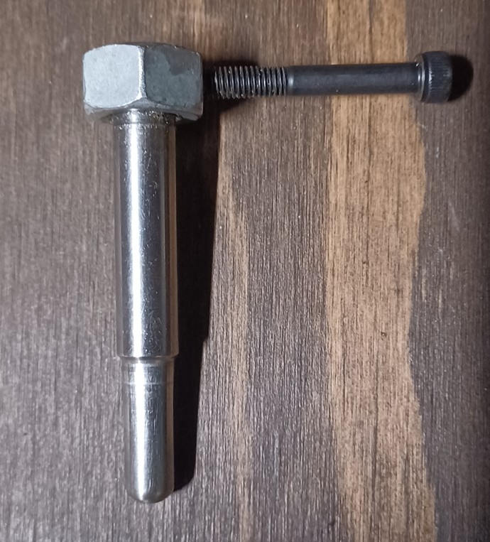

How does your expander work?
pat i posted this 04 August 2025
Tap it with a little hammer

Is the Partner half way between a Rock Chucker and Junior?
I'm pretty sure the Partner is at the bottom of the RCBS press list. It's an aluminum framed beginner's press, which means light for transport, but seems pretty sturdy. I know it's pretty popular with jacketed benchrest shooters. I was a little worried the arm would be too long and hit the seat of a picnic table so replaced it today with a 7/16-20 x 4 bolt. It still has enough camming action to full length resize 06 brass with no problem.

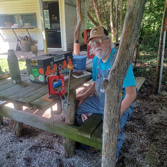

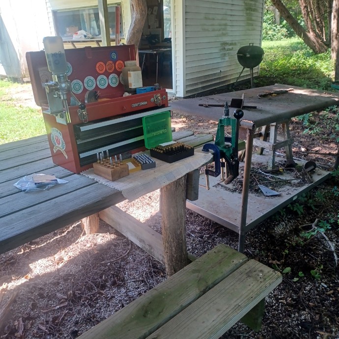

I really thought my portable system was unique until I went to a match at Windhill today. The handsome guy sitting down is Dan Hudson, past CBA President and national champion at least once with his portable Lee press. The other set up is one being shared by Larry and Chad Rickertsen. Larry a past Dir. of Postals and national champion and Chad his son who's no slouch behind a trigger and all around nice guy who competes in both HVY and PBB classes to real good effect. He shot a 200 at last months match.
Anyway I guess this is a pretty common item with shooters who load at the range and I'm not as smart as I thought I was.
Capt45 posted this 24 August 2025
That second setup looks as rudimentary as anything I've used, except that pwd measure attached to the Craftsman tool box; Harrell's I believe. That's a top of the line measure.
pat i posted this 24 August 2025
Yes it's a Harrel's Larry uses. I tried using mine but it chokes on the AA#9 I use so use a Redding BR30 instead. Don't hold me to it but I'm thinking Dan uses a Neil Jones. I'm sure if wrong he'll set me straight in short order. I don't know what die they're using, possibly Neil Jones, so maybe they can enlighten me. I think their results are due more to their loading, casting. and wind reading ability than equipment used but having good tools obviously doesn't hurt.

My powder measure isn't marked and I don't remember the maker, I bought it from a jacketed BR shooter who had more than one of them. My neck die is a Neil Jones.
