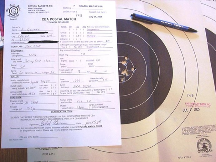

I suspose it is just bragging, but I think most of us have taken pictures of our really great targets. While looking for another photo today, I found this one. It was my first CBA 100 6X with a Springfield 1903.
Anyone else want to brag a little?

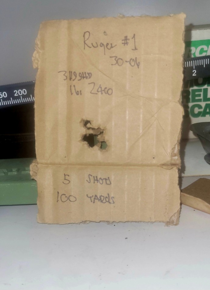

my lucky group with the 30-06 Ruger #1.
 Group before about 1.5" and group after about 2" IIRC.
muley posted this 14 February 2025
competitive load, looks good
