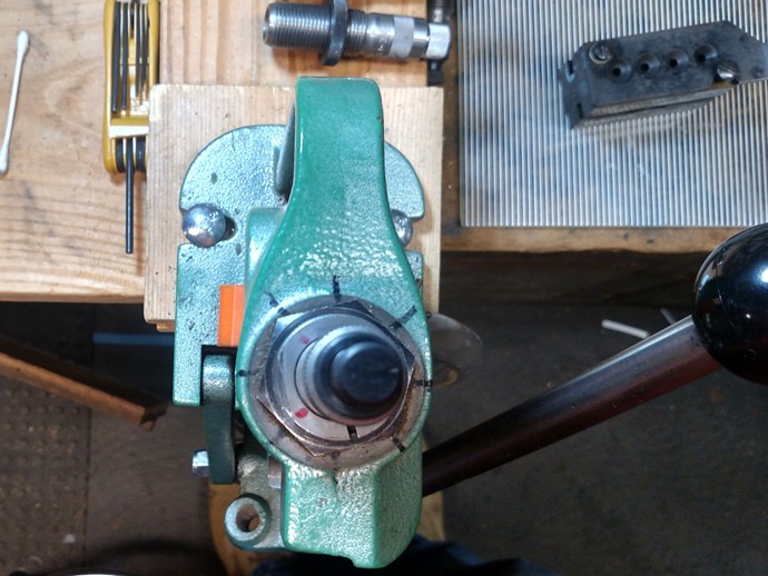

When testing new loads I like to make settings standard on like expanding or belling brass, amount of crimp, makes bullet seating much more plug and play going from one bullet style to another.
For example, bullet seating, I take a belled piece of brass place it on the stockholder, screw down the seating/crimp die until the die is two finger tight, back it off one half of a full rotation, lower the ram seat a bullet on the primed, belled, and charged case. Run the ram back up seating the bullet the appropriate depth, lower ram loosen the bullet stem a couple rotations, tighten the die to the initial setting for zero crimp, two additional tick marks for my medium crimp, snug the bullet stem to the freshly seated and crimped round. Rinse and repeat for 99 more rounds.
Short answer, easily repeatable settings on dies with reasonable tolerance. Verses using just a “tich” more or less adjustments when loading.
