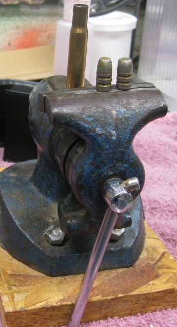

Ken, after pondering what you wrote, I decided to experiment with the vise. Beagling, lapping, and bumping are no doubt more refined/controlled, but the vise experiment is pretty quick. I've read about that idea before, but dismissed it as too crude. If you are seriously suggesting it, it must not be totally off the wall. It didn't take much effort with my little vice to expand the nose from .308 to .311+. Base went from .310 to .315. Shortened from .645 to .598! It's easy to see the difference in the picture. No micrometer required. No clue how bent this bullet may be now! I may need to refine my squishing technique a little, but I'll fire off 20 or so of these and see how they do.  Cartridge was added just to show how puny the vise is that did all that “improving.” We'll see. big_grin

Ken Campbell Iowa posted this 17 February 2017
ha ... i love it !! ...you should see if the bullet will chamber in your '94 before you size the base dia. down ...

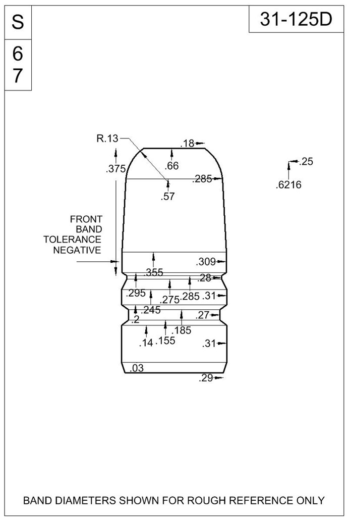

I would like to see close-up photos of the BASES of your fired bullets.  I believe that in extruding the square-edged, sharp-based bullet into the tighter .30-30 barrel that you are dragging a “fin” off the base.  That wire edge has less heat capacity than a more rounded or beveled base, which upon upset gives the displaced material somewhere to flow.
The Accurate 31-125D in a plain, bevel-based bullet I intended for small game loads in .30 cal. rifles which could be loaded as-cast without sizing, simply tumbling in Lee Liquid Alox diluted 50-50 with mineral spirits, to provide a very thin lube coating all over, just enough to turn the bullets a uniform “brassy” color, making no attempt to fill the grease grooves.
In the .30-30 I use 3.0 to 5.0 grains of Bullseye.
