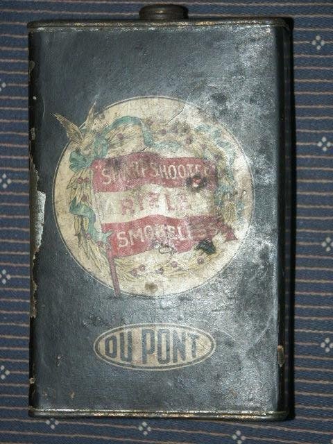

"Sharpshooter and SR80"
By 1900 - Much information by John Kort
By the early 1900's, Sharpshooter replaced Dupont #2.
Unlike Dupont #2, L&R Sharpshooter was specifically used in black powder frame firearms. I assume this must be because of the addition of the flame-deterrent coatings that would retard burning allowing lower pressure curves even lower than black powder. In 1903 the High Velocity .44-40 cartridge was introduced. It to used "Sharpshooter" powder in larger doses to achieve its 1,570 f.p.s. velocity. (note Sharpshooter powder can photograph below) They were discontinued by the mid 1940's.

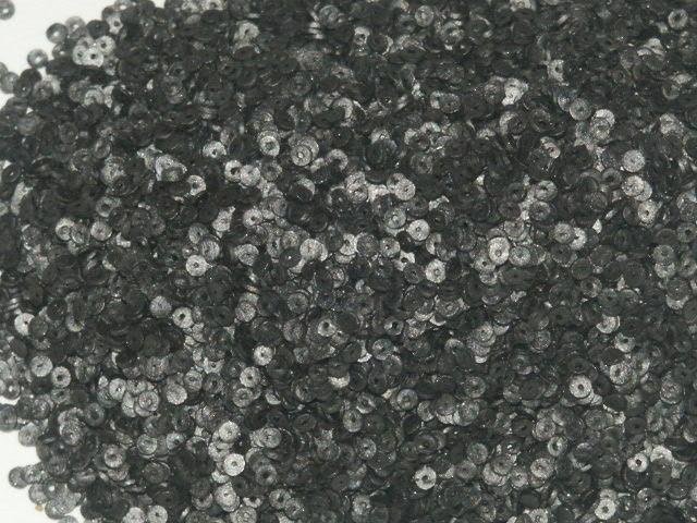

In 1913, DuPont introduced SR80 (Sporting Rifle) . It was a granular type powder, similar in appearance to DuPont No.2 Bulk Smokeless but was a bit faster burning and was not a "bulk" type powder. It's burning rate was in the same range as "Sharpshooter".

there is SR80 "more dense" and there is SR80 "less dense". I say that because I have had the pleasure of working with 5 different lots of SR80 and found that some are more dense than others.
It was one of the powders used in factory ammunition for many of the low pressure factory cartridges.... .22 W.C.F., .32-20, .32-40, .38-40, .38-55, .44-40, etc.
It is considered to be a gelentanized powder and thus pretty impervious to moisture which was not true of the old DuPont No. 1 & No. 2 bulk smokeless powders.
I currently use what I have in the .22 W.C.F., .44-40 and .30-30 SR (Short Range) cartridges. It produces accuracy as good as any other powders I have tried in those applications. 14 grs. in the least dense lot of SR80 that I have, is a capacity load in the .44-40 and produces very good groups @ 1,290 f.p.s.
17 grs. of 4759 is the equivalent to 14 grs. of SR80 in my .44-40. That is with the lots of powder I have and doesn't necessarily mean that the % difference would be the same with different lots and/or different cartridges.
Regarding the smell, Frank Marshall ("Speaking Frankly" column - CBA) said it was the "perfume" powder. I would describe the smell as "barnyard". Since it was around from 1913 to 1939, no doubt, tons of it were used by the factories and reloaders.

Early Smokeless Powder was sold in Kegs just like black powder. The kegs came in various sizes...some not much bigger than a can of beans. Below are some examples of kegs and flask type containers.
Note that Dupont #5 was also used but only for Pistols.

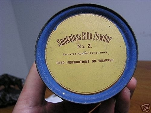

Dupont #2 was patented in 1893 and was sold under the "Deer Banner" not as No. 2. It was a semi-bulk powder and not very popular compared to No. 1 or Shotgun Bulk.  ~photos from RicinYakima
