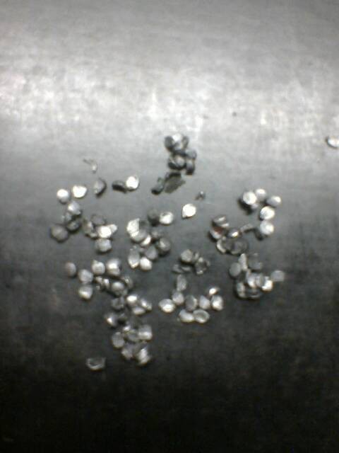

After my discussion last week regarding lubes and whether to change or not, decided to purge the Lube'a'sizer and put a fresh batch of new (not 30yrs old) lube into the tube.
It was all working fine until I noticed a change in the sound of the lube melting out of the sizer and falling into the tin I had conveniently placed underneath. Instead of a soft sound it was tink tink tink.
When it was cool enough to only burn slightly I retrieved some of the hard fragments of what was in the lube. I had extruded pieces of lead. I sized about 50 357 projectiles from #2 on Friday night for the weekend and it seems that they were extruding through the lube holes in the sizing die and back into the lube reservoir, no wonder I wasn't getting a full fill.
The projectiles drop from the mould at 359 and I can't use them unsized as they swell the cases too much to chamber so have to size them to 357.
Has anyone else come across this previous, does anyone purge their sizer. When I melted the lube out of the actual sizing die I had extrusions in two of the lube ports and one in the lube channel itself in the die.
Thoughts appreciated.
Lead extrusions
Ed Harris posted this 05 May 2019
Yup!  Lyman size dies very often shave particles off lead bullets when sizing.  That is why I quit using them for match bullets and went to RCBS instead.

joeb33050 posted this 05 May 2019
I'VE HAD lYMAN 45 AND 450 LUBRISIZERS SINCE 1960, replaced lube many times over the years. I remove the obvious parts. put the machine in a cookie pan, held up in the air and tilted, in the oven and all the lube comes out. I have never seen pieces of lead as shown, and I bumped thousands of bullets, cleaned dozens of sizer dies. Something else is happening, it ain't the machine or lyman dies.

tony1960 posted this 05 May 2019
Thanks guys, this is an RCBS machine that I've had since the early 80's, never seen anything like this before.
The only reason I bothered to clean it, and found the problem is I wanted to change the lube, or just size and then tumble lube. I've been toying with the idea of making a batch of 45-45-10 just for interest sake. I've never seen the problem with any of my 30 or 44 cal dies, but they mostly fall pretty close to size and the die just makes sure they're round.
I may have to check the hardness of what I dropped, but that shouldn't make a difference. Oh well, something else to do during the week.
