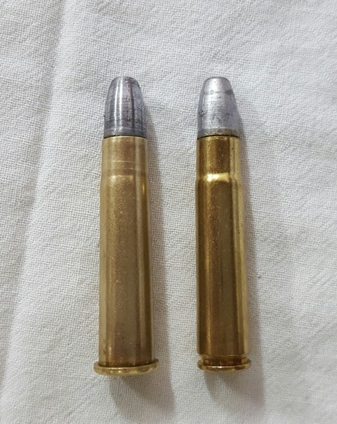

I was cleaning up a box of assorted brass and came across my first cast bullet benchrest cartridge. The story is all I had for reamers at the time was a 45/70 and a 30/06. Wanting a short 30 I turned a spare 06 sizing die down until I thought the length looked about right and ran a 35 Remington case in to end up with this. Of course there was trimming and neck turning involved but I don't remember it being overwhelming.  For a gun I had an old cheap plastic stocked Savage 110 in 22/250 I got from a store going out of business for 99 bucks. I took a 3x3x6 piece of walnut and routered it out to fit on the forend. A little epoxy and sanding and I had my br stock. I fit a Shilen select match barrel to it and away I went. I don't remember how it shot but I don't think it did too bad. This was the first barrel I chambered and fit after taking an evening class at a community college and buying an old Sheldon lathe. Sometimes not knowing what you're doing but doung it anyway works out. I'm sure I'm leaving out stuff because my memory is shot but it's close. I think I was calling it a 30/35.

Here it is next to a 06 case.

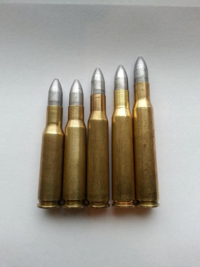

Back in the late '70s, early '80s I also had similar thoughts.  I set back a new 2 groove '03A3 barrel and installed it on a M93 action.  Then I short chambered it with a 308W reamer and lengthened the neck to '06 length with an '06 reamer creating what I called the 308 CBC at the time.  It's the left cartridge with a standard 308W next to it.
Middle cartridge is the 30x57 XCB which is a short chambered '06.  Idea there was to create an inexpensive 30 cal wildcat with case capacity of the 308W, the longer '06 neck and correct case body taper for trouble free feeding in Mauser actions.  It is an excellent cast bullet cartridge for higher velocities using the NOE 30 XCB cast bullet up through 2600 fps with 13 - 16" twist barrels.
Forth cartridge is the 30x60 XCP which was developed to give 3000+/- fps out of 27" + barrels with 16 or 17" twists.  I built one on a CZ24 M98 Mauser action with a 16" twist barrel of 31" length.  [Tim Malcom of MBT in Conway Arkansas did the rebarrel and chambering]  That rifle has shot 10 shot moa groups consistently out to 600 yards with the 30 XCB bullet pushed at 2900 fps.
Right end cartridge is a standard 30-06 for comparison.

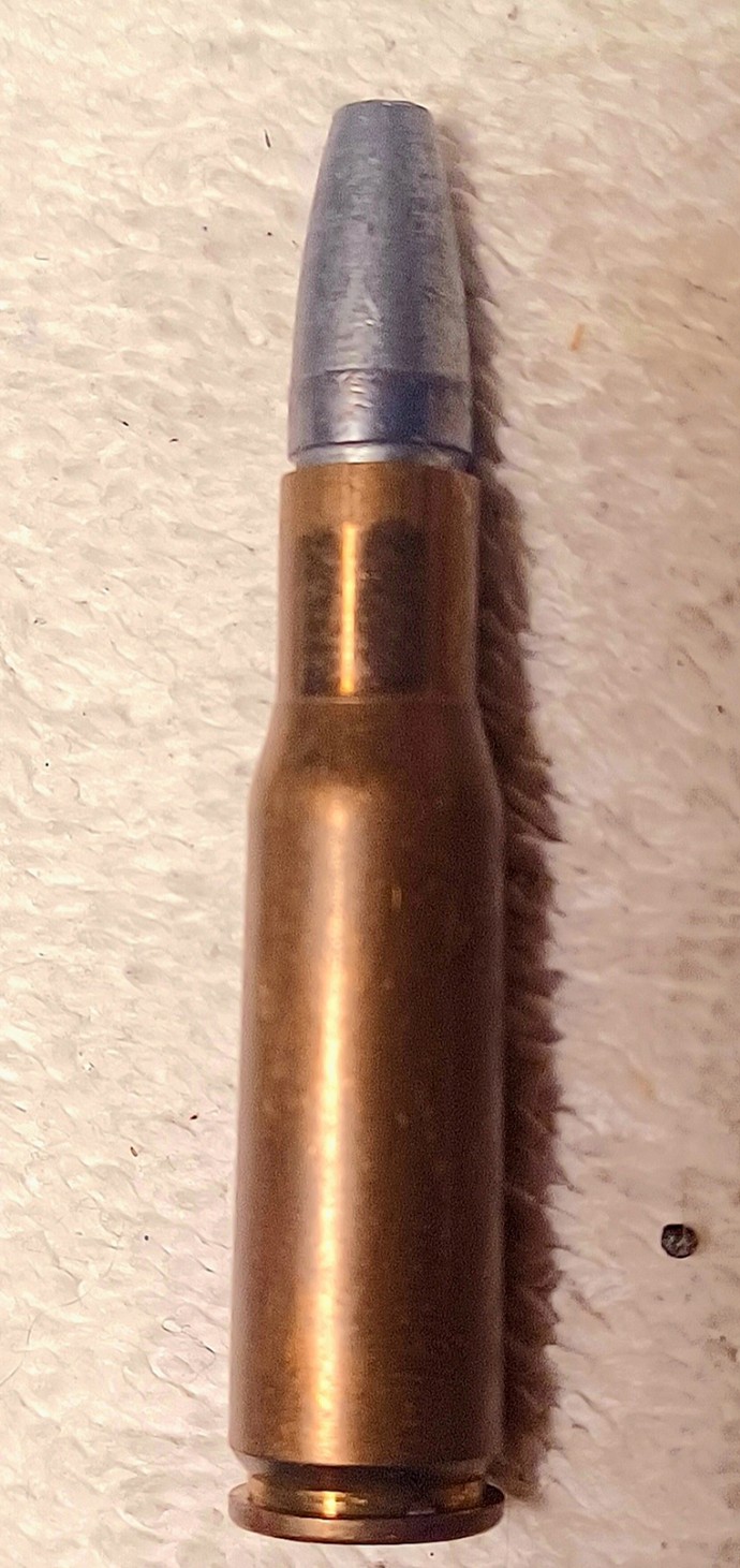

This is a Wildcat that I designed and chambered into my rebarrelled rear grip XP100.
The 30 SCBS   aka 30 SeitzCastBulletSpecial
It is a shortened, long neck 300 Savage. Short chambered with 300 Sav reamer, then (carefully) lengthened
the neck with a 30-06 reeamer. Had to cut off the 300 sav die to size form the brass from 308W cases
Left to right, Chicken load  130 gr H&G bullet
                     Pig and Turkey, 162 gr  311466
                     Rams,                190 gr 311334
Ram load clocked 1950 for sure knock down wherever I hit the rams

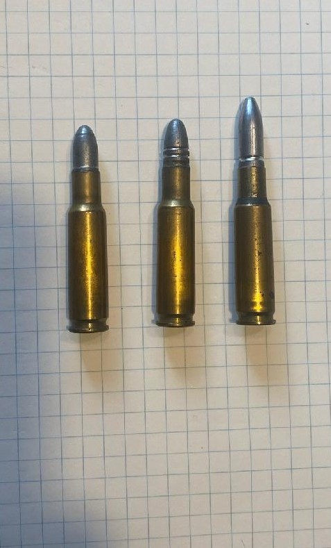

One of my wildcats is what I called the 8mmSKSKurtz. I cut a 8x57 die to an length that was close to the 8mm Kurtz of WW2 and I had a brand new 8x57 Yugo barrel and cut the chamber back to fit my wildcat and machined it to fit an SKS barreled action I had. Lots of work. I also make the fit up with a Savage like barrel nut. It cam out pretty good and it was able to launch a 175 grain LEE cast 8mm bullet to 2300-2400 fps. I could load about five rounds in the SKS magazine as my wildcat wasn't as tapered at the original 7x62 by 39. I think I used 6.5 Mannlicher brass to form the cases.
