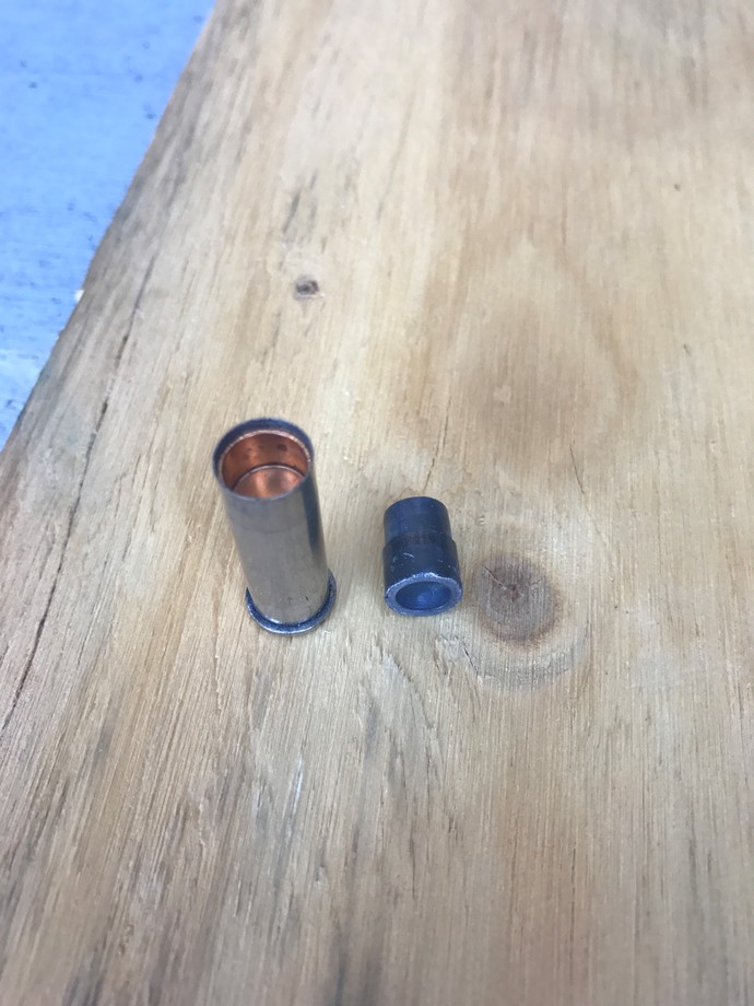

Has anybody ever seen a hollow point, swaged, gaschecked .38 special wadcutter? I was given a box of loaded ammo today and pulled one of the bullets as I wanted to show the donor that the WC was reversed. Upon pulling it I found it to be gas checked and swaged. Lube appears to be a graphite of some sort. The box the ammo came in appeared to be a yellow Western box from the 40's-50's era. Ammo appears to be reloads as the front of the box references SWC bullets.

Alberts Bullets in Franklin Lakes, NJ made a similar bullet for a commercial reloader in the 1980s. Jerry Alberts is now deceased, and the swaging machines he had were bought by Federal from what I understand. Jerry pioneered the process for swaging the HydaShok bullets and figured out how to make them at a high production rate without the bullets sticking on the punch. He was a clever tool maker who got his start at the Picatinny Arsenal.
It's not gaschecked, but I do have an original Ideal 38 cal "manstopper" mold from the late 1920s-30s. It's essentially a hollowpoint wadcutter, not a reversed hollowbase design that would have different expansion dynamics. I really need to case a few samples with it. Once again, it is quite different from the hollowbase in bullet profile, and in the cavity, which appears to be designed to expand in a consistent manner, but limit the rate of expansion, and the maximum expanded diameter.
I've been thinking about having Accurate make me a four cavity mould, based on the original design as a base pour, then having Erik hollowpoint all four cavities.
After I looked at the bullet closer I realized it's not a gas check on the bottom, it's a half jacket. Haven't seen one of those since we ordered some from Herter's in the 60's.
Yup. Did the half-jackets back in the early 60's.
Looks like a swaged concoction!
